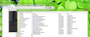

I've been using AeroGlass from the very first beta for Windows 8. Now I've moved to Windows 8.1 and still been using it, a really nice piece of software :D however, even with the most recent version I cannot understand how to get window titles glow effect and aero stripes as seen in all the screenshots here, I've got the transparency, yes, but nothing else :huh: I've downloaded some theme resources pngs, noelc's glow.bmp, put them all in the AeroGlass folder, even played with AeroConfigurator but to no avail. Can anyone help me with this? Thanks in advance
post-376963-0-88460700-1388945480_thumb.
Edited by kientrongtran
To be able to use a custom glow.bmp, themeatlas.png and glow effects I believe you must have the dwm symbols installed.
Example (my files are in C:\BIN):
Windows Registry Editor Version 5.00[HKEY_LOCAL_MACHINE\Software\Microsoft\Windows\DWM]"CustomThemeAtlas"="C:\\BIN\\themeatlas.png""ColorizationGlassReflectionIntensity"=dword:00000030"CustomThemeReflection"="C:\\BIN\\AeroGlassReflectionImage.png""TextGlowMode"=dword:00000001
-Noel
