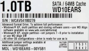

Whether the internal Sectors are 4K or 512B is not an issue here. It will only affect performance.
4K Logical Sectors would be a major issue, but are only used in USB Drives larger than 2TiB.
Standard tools and software can be used without problems. Special tools are only needed if you want the Hard Drive to run faster.
jaclaz *is* right (of course, as always!): HDDErase is faster than Active KILLDISK. The latter remains useful when one wants to zero out just some parts of a HDD, but HDDErase is way faster for a full disk wipe, and the results are equivalent. Now, that said, here's what a WD Advanced Format Drive looks like:
Your 80 GB does *not* have the phrase "Advanced Format Drive" anywhere on its label, hence it uses 512 byte sectors.
That said, you may proceed as per my original instructions, but using HDDErase instead of Active KILLDISK, in the first step. HDDErase also is a DOS program, so very little has changed in those instructions. You can proceed, as agreed.
Actually on the thread DeadDude found (actually NOT that one, but near it ;)) :
http://community.wdc.com/t5/Desktop/Physical-Sector-Size-different-between-WD20EARS-00MVWB0-and/td-p/218226
there is an interesting report.
An advanced format drive (even if "internally" has 4 Kb sectors) should expose outside a 512 byte one.
The XP alignment issue is seemingly only EITHER:
  • jumper 7 and 8 -> add a fake sector so that XP Disk Manager starts first partition on sector 64 instead of 63
  • Advanced WD format -> simply a "modified" partitioner that uses multiples of 4 x 512 as addresses
The thingy on VIsta :ph34r: or 7 is not needed as they will anyway normally start at 2048.
This is consistent with the "scarce" literature available and with "common sense".
It would be interesting to try partitioning such a drive under Vista :ph34r: or 7 with the Registry patched to respect cylinder boundary. :unsure:
The thread reports the fact that - probably due to a mis-configuration in the factory - the particular drive talked of there does not "expose" the right sector size.
So it seems like this is possible, though I find very queer that it happens on such a smallish (for today's standards) disk size as 80 Gb.
I would try contacting WD support, as what Deaddude bought was a disk with 156,301,488 sectors (of 512 bytes each).
