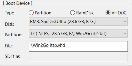

I  did the shrink and copied the files and looked at the BCD in \EFI\Microsoft\Boot\ and the disk and partition entries are blank again. Should I redo them  like I originally did above?
Edited by click-click
Yes, make sure they point to your NTFS partition where the VHD is located.
Posted (edited)
Same problem and still ignoring.:no: Boots ok on the non-uefi laptop. Does it make any difference if secure boot is turned off?
Posted (edited)
I redid a flash with Rufus with NTFS support and copied everything over. On the  first try, the boot started, but then complained about bootx64.efi missing, so I copied that over into \EFI\boot and got further. Now I'm stuck with the following error. Can't find winload.efi
I think the new Lenovo E15 is a 64-bit machine which is why I think the HW was looking for bootx64.efi. Could my problem be that booting a 32-bit Win 10 with UEFI is not supported on that machine?
If this is the case, will installing a 64-bit in the vhd be enough?
With the Rufus setup with NTFS, booting UEFI flash with 64-bit OS on a 64-bit machine now works via F12 boot menu, but  booting is ignored on my BIOS machine via F12 Boot menu. I have to boot it directly from my Bootit Bare Metal boot menu.  Not sure why though.

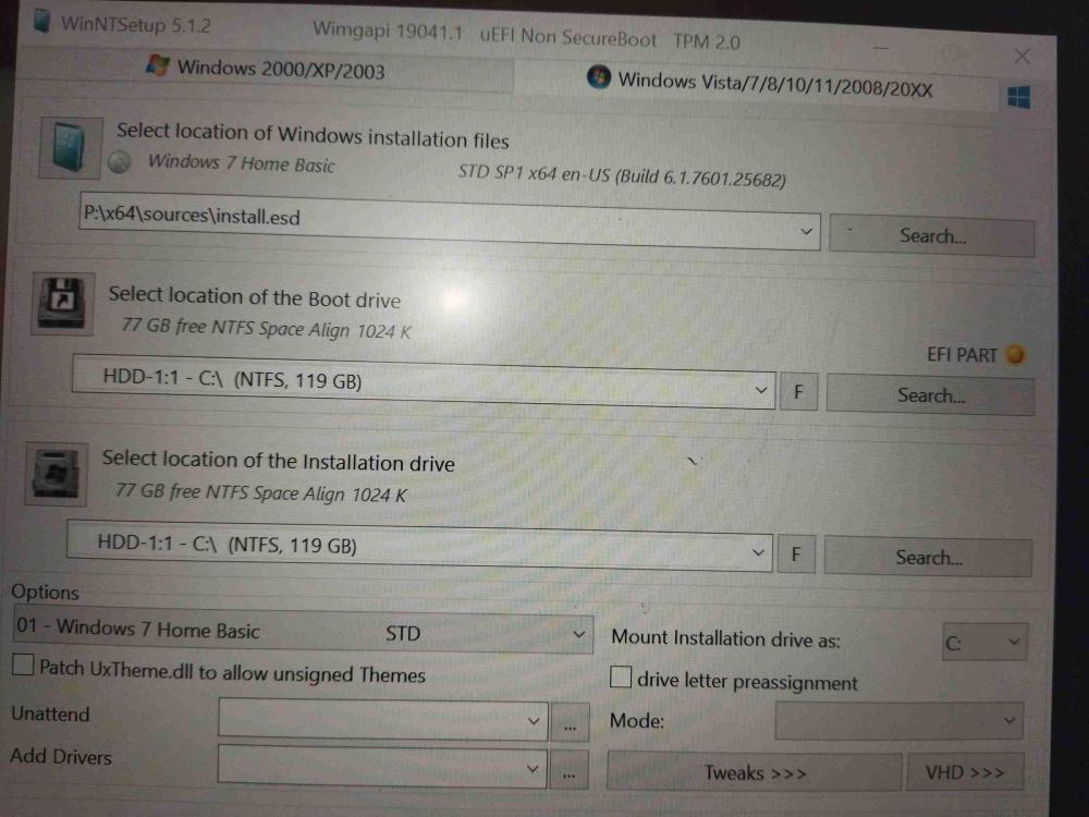

i am using the last version to install win 7 on GPT HDD  with UEFI  only
after restart it doesn't complete the installation and show there is no system installed and need to install new windows
i think the problem that EFI PART is yellow
how i can fix that to complete installation
thanks
You need to partition your drive correctly, there should to be a FAT32 partition as boot drive.
thanks for your reply
can you please tell me the best partition of my drive to work without problem
can i install win 7 and  win 10 " dual  boot windows "  by  WinNTSetup
many thanks for your help
Just shrink your C drive by 100 MB to 1 GB and create a FAT32 partiton from the new free space.
Ideally, but not necessary use diskpart's set id with c12a7328-f81f-11d2-ba4b-00a0c93ec93b to mark this partition a ESP.
Select this one as boot drive in WinNTSetup and install your Win7.
After you successfully booted Winows 7 to desktop you can select the same boot drive
but another partition and install your Win10.
