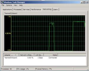

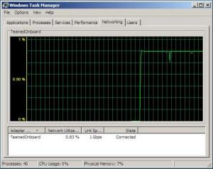

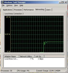

One last post before I leave for the weekend... I think I need to sleep on all this new stuff I learned today... Server 2003 Disabled security options for Microsoft Network Server/Client: Digitally sign communications (always) no change. Ran PCATTCP to test network speeds. Default switches used ie: pcattcp -t -f M hostname XP -> 2003 = 53.87MB/sec = 430.96Mbps 2003 -> XP = 73.39MB/sec = 587.12Mbps These numbers are surely better, but then again they are with 1 packet, not with a large file. I will run this test on the 2008 on Monday. I am thinking that if we can get these speeds with file transfer to the Server from the XP computer, then that will be sufficient, as to how to get them is another story. I also must note that while I am using a computer with XP to do this network testing, the computers that require this speed run in a WinPE on a RAMDISK (WinPE via PXE), so any configs done to the XP machine would need to be translated to the PE if they, in fact, do work to our benefit. See you next week! PS: check sig for server/network config in case you think its a problem with them.
