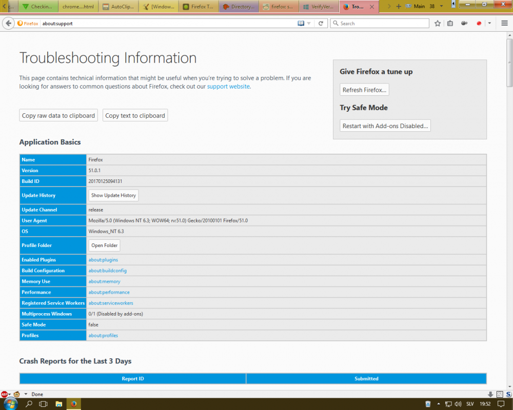

Compatibility modes only hook legacy GetVersion and GetVersionEx APIs, Firefox uses VerifyVersionInfo. There is a bunch of CSS stuff in there that adjust UI differently if ran on Windows 10. Supposedly whole capability for querying OS version using CSS was implemented so the UI can adjust according to the used OS. I'd really like to know where exactly Windows caches manifests. Because just saving the file with Resource Hacker didn't change anything. Only when the modified date changes on the .exe it will re-read the manifest. When you put back the original modified date, it will use original manifest.
I removed Windows 10 GUID from firefox.exe's manifest with Resource Hacker, then altered firefox.exe's last modified date by opening it and saving it again with Notepad++ for Windows to register new manifest (Resource Hacker doesn't do it). It's better to change the date with BulkFileChanger. Logging off might also be sufficient on recent Windows 10 builds. Now it thinks it runs on Windows 8.1 and behaves just like it does on said OS.
@NoelC Exactly, you only need it if you want glass at other places. And then the URL bar and search bar have greater heights, which is also Windows 10 only behavior. I use Firefox on Ubuntu occasionally, where I get the exact frame according to Window Decoration settings. It's only Windows 10 where it has to act differently.

Firefox has these oddities only when ran on Windows 10. On older Windows versions, its default title bar has glass effect, along with standard 3 buttons straight from theme atlas image. If only there was a switch to turn off this Windows 10 mode.
