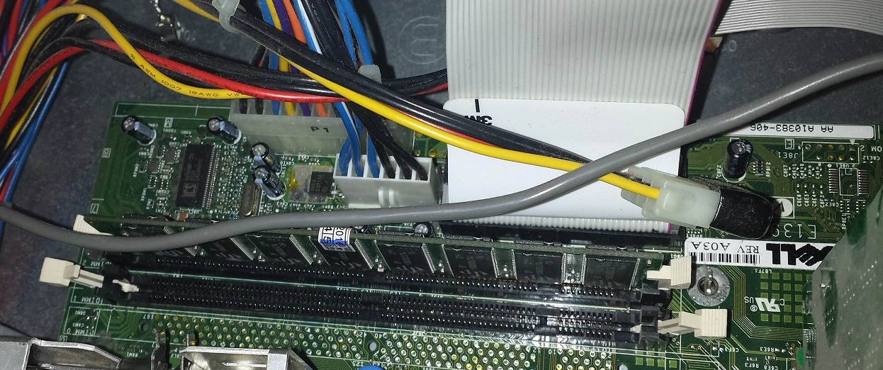

Dell Auxiliary 6-pin Adapter Not Fitting
Goodmaneuver replied to Ryder252's topic in Hardware Hangout
I see you have an original 4100 power supply does it work? All you need is a multimeter to measure the voltages. A paper clip bridged from pin 11 Grey to pin 12 Black will power it up. I would not do that until you know what voltage is what on the motherboard. Most motherboards had an optional 6pin inline connector but the 4100 they say will not work with out the 6pin aux power connector. The P10 connector adapter in the link is not correct because of the tab assignment on the outer side of the 6pin not fitting. I am fairly sure that the P10 adapter in the link is not going to be compatible and also not compatible with all the proclaimed Dell models in the link. You just need to do the optical check of the wiring to know if it lines up with the Dell Pentium 11 and 111 picture I sent in. -
The Codegen X or XA or XX models had a 6pin inline connector but I am still not sure if it is compatible with 4100 due to lack of pinout connection diagrams for 4100. Also the 4100 would have a different 20pin assignment than a standard ATX PSU see picture. You might be able to shift the 20pin plug along as shown here. https://www.vogons.org/viewtopic.php?p=668990#p668990 The old Pentium11 power supplies had 2 x 6pin inline connectors. They had different keyed little tabs on the side so that they were not made interchangeable. All indications for the Dimension 4100 point to a proprietary made power supply. Dimension 4200 used the standard ATX 20pin. Example of a X model Codegen. https://www.ebay.com -
