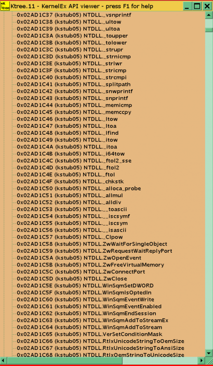

  3. Your inferred assumptions are incorrect. There is little or no benefit from using more than one Kstub then and it is not the sort that creates the issue. Having ordinal functioning in Kstub is a good improvement but I would like to see ordinals implemented into Kstub824 without the other changes that were implemented creating Kstub825. Assuming that you are talking about kstub modules only I understand. It seems ktree is only guessing where kstub loads the redirection of APIs or does kstub need a free range of memory just below its base address. Cisco Systems made a GINA module that is completely compatible with WinMe. It is called CSGINA.dll and a web search will find a download. Rename it MSGINA or tell registry that MSGINA is CSGINA in system KnownDlls. MSGINA will load every time the OS goes to restart or shutdown.

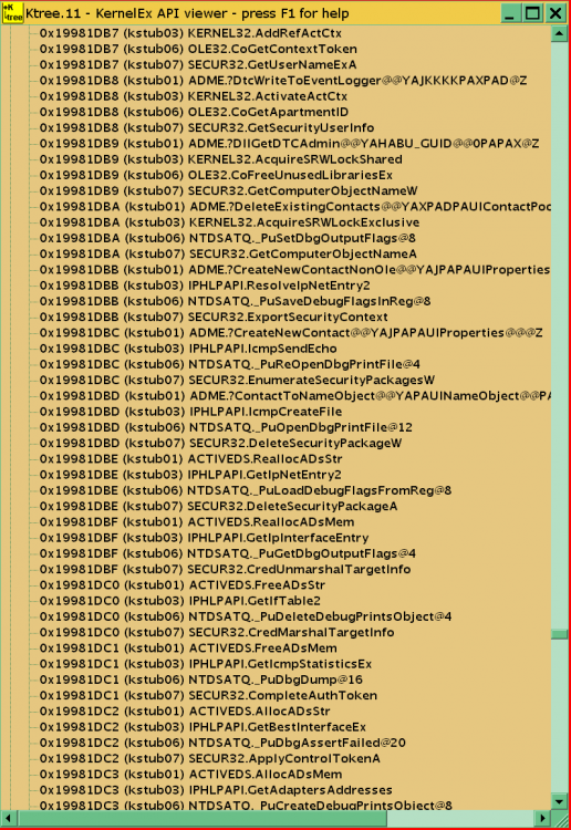

  6. I have duplication of addressing shown in Ktree. Is this a correct phenomenon? See picture for example. Has Kstubs got a limited range of memory it can allocate? Max address as shown in Ktree is 0x19881dc7 and Min is 0x02371bd8. I have Kstub825 in use with Kstub02 and Kstub08. If I use all Kstub824 modules I get 7x duplication of the same address shown in Ktree where as using the 2x Kstub825 modules I get only 4 duplicates. The duplication occurs at the maximum addresses. If I use all Kstub825 modules then KernelEx is broken and does not work as explained before :- the size limit of the INI files needs to be reduced with a stringed sequence of Kstub825s.

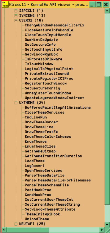

  7. Over the last few months I have been experimenting with 4.5.2 with the emphasis on non-stubbing. Started with exact same OS build as I had for KernelEx25. Kstub825 behaves correctly with this arrangement as far as not mixing up User32 with Uxtheme. It came back again and only happens with UnregisterTouchWindow and Userenv module is named by Kstub825 log also as having UnregisterTouchWindow redirection. Using Kstub824 for months and it does not happen. The size limit of a stringed Kstub825 as mentioned before still remains. I have included a screen shot of address order of part of NTDLL. A simple Bubble sort did not use an algorithm that recognized special characters. This is what Dependency Walker uses to sort out the functions in order. It ignores the underscores. This is why I mentioned list string compare lstrcmpi as a sort method which uses a word sort. If your statement is 100% correct than I have the Kstub.ini not sorted correctly. Looking at my picture and the reverse address sort would be ZwWaitForsingleObject _Clpow __isascii __iscsym __iscsymf __toascii _alldiv So this is a correct sort as Ktree shows? I used to sort with MS Excel and have recently sorted having underscores precedence over uppercase and lowercase but Ktree says question mark then numerals then uppercase then underscore then lowercase. Sort orders can vary where numbers are before symbols for example?

  10. Kstubs825 does not behave properly as it confuses User32 with Uxtheme as see in the Kstub07.zip. Evidence in upload zip and Ktree11 picture. As can be see in picture that there is no reference to Uxtheme for UnregisterTouchWindow and Kstub824 in the log zip redirects all 3 Touch Window functions from their rightful caller :- User32. KSTUB07.zip
