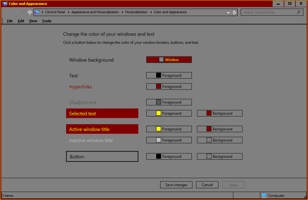

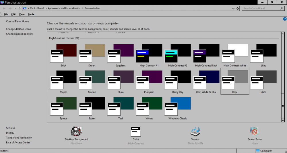

  6. Windows has reset the handles for the Personalization app you know. The calls now require that you reference a shell (in this case, explorer) in order to redirect a command that would normally send the user to a Modern UI version. Chain references are broken - if you click wallpaper in the shell I screenshotted, you will be taken to the Modern UI. However, if you click Desktop Icons, Sounds, or Screensaver you will stay in the Explorer Shell. That website you reference hasn't touched a Windows OS since Th2. Their references are out of date. Please note I am running Build 16232 and my shortcuts work. Because I'm an Insider, I can get the latest information to ensure I'm giving accurate advice to users who find Microsoft's choices a pain in their arse.
  7. Shell commands need a shell. That command is invalid because it lacks a shell reference. My commands all check out and are not blacklisted. Replacing DLLs that work just fine is dangerous and you risk causing DWM-related crashes, making Windows unable to materialize. Not only did I provide a shell shortcut already, I provided screenshots.

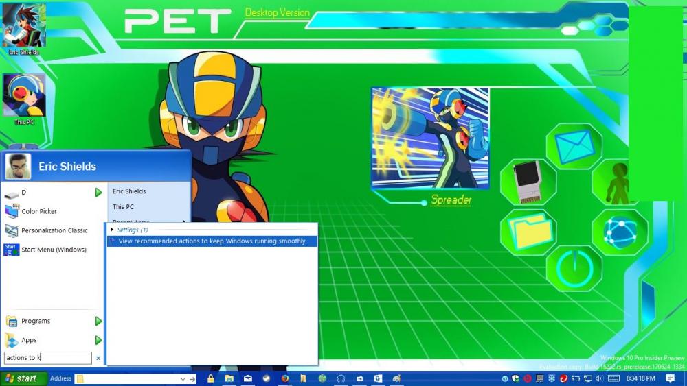

  10. Whenever you install a third party antivirus or antispyware provider, you need to allow it permanent access to the firewall on both public and private networks. Do not ignore that dialog you saw. Click your third party AV-AS and click "Turn On", and you'll see what I mentioned above. You shouldn't be asked again, unless you update your build of Windows. Is this what you saw? But with your provider? To access that dialog follow the steps shown. I'm using classic shell but Cortana will pull the same results. If you really can't find what you see, use the All Tasks Shortcut for Control Panel: Right click > New shortcut and paste blue text below: %windir%\explorer.exe shell:::{ED7BA470-8E54-465E-825C-99712043E01C} You should type action c and you'll see the result you want.

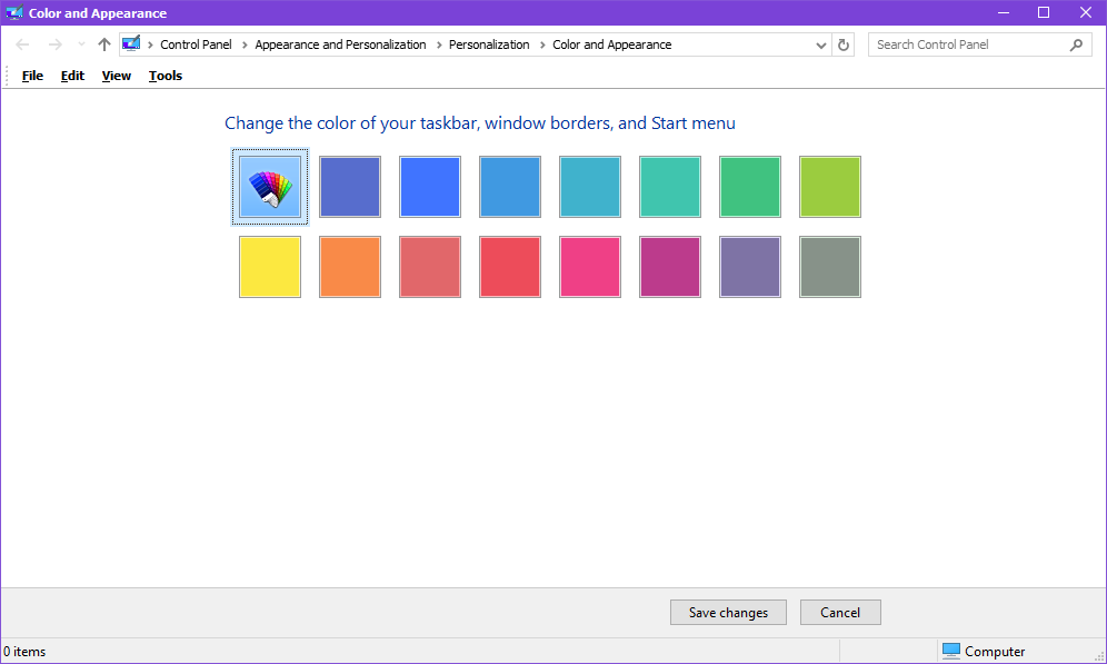

  12. You're missing a few elements in that shortcut. Is this what you are trying to achieve? I'm on Build 16232 and I'm a Slow Ring Insider. If you click any link you WILL be sent to the modern UI though. Color Picker: C:\Windows\explorer.exe shell:::{26EE0668-A00A-44D7-9371-BEB064C98683}\1\::{ED834ED6-4B5A-4bfe-8F11-A626DCB6A921}\pageColorization Classic Personalize: C:\Windows\explorer.exe shell:::{26EE0668-A00A-44D7-9371-BEB064C98683}\1\::{ED834ED6-4B5A-4BFE-8F11-A626DCB6A921}"
