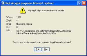

@IceMan: nice idea. I tried your program but eh it didnt work. When i have choosen few devices, set right path and stated your program i got error saying
To make polish story short it says Script Error from internet Explorer.
And btw can you give me more info how you are backing up drivers? With steps prefered. I wanted to include this feature in my program Hardware instaler that is on this forum with Sticky.

@madboy - what is the name of the driver it was attempting to back up? And did it contain any special characters, that would not be allowed in a file or directory name? And What directory are you backing up to? I thought I had removed all of the special characters and replaced them with underscores but where it says it is failing is on creating the folder to back up to.
