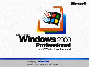

murvun Posted August 5, 2005 Posted August 5, 2005 (edited) hello world!how to avoid this freeze?used german w2k, files prepared as written on fred vorcks page (up to step thirteen), used nlite only for building the iso-imagefreeze on first gui-start (before you enter the serial number)edit: ooops - freezes also without hfslipso I have to re-install my development-system.sorry.thanks. Edited August 31, 2005 by murvun
