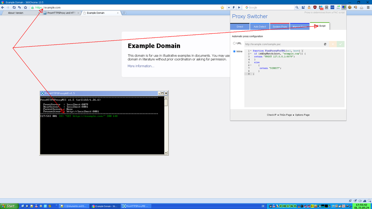

AstroSkipper Posted May 21, 2024 Author Posted May 21, 2024 29 minutes ago, Anbima said: It doesn't work for me. I have entered the PAC script. Should the tick be green? I can't confirm anything. What am I doing wrong? ... For me it must be "*.example.com". Then it works. No. What about that here: 3
AstroSkipper Posted May 21, 2024 Author Posted May 21, 2024 (edited) 53 minutes ago, Anbima said: It doesn't work for me. For me. it works as it should. 53 minutes ago, Anbima said: Should the tick be green? I can't confirm anything. No. No green. Just insert the PAC script code! You won't get any confirmation messages. 53 minutes ago, Anbima said: What am I doing wrong? I really don't know what you are doing. All a bit strange. 53 minutes ago, Anbima said: .. For me it must be "*.example.com". Then it works. "example.com" is completely sufficient and exactly corresponds to the URL which you wanted to load. Edited May 21, 2024 by AstroSkipper Correction 3
NotHereToPlayGames Posted May 21, 2024 Posted May 21, 2024 9 minutes ago, AstroSkipper said: exactly corresponds to the URL which you wanted to load I actually think what he's trying to do is for one.example.com two.example.com three.example.com www.example.com and what you are proposing will only work for example.com 1
AstroSkipper Posted May 21, 2024 Author Posted May 21, 2024 10 minutes ago, NotHereToPlayGames said: I actually think what he's trying to do is for one.example.com two.example.com three.example.com www.example.com and what you are proposing will only work for example.com @Anbima didn't say anything about that. If one doesn't make clear announcements, one can't expect to get exactly the information one needs. We are not clairvoyants. If the PAC script contains a different URL than the one you want to call up, you don't have to be surprised that it doesn't work. 3
Anbima Posted May 21, 2024 Posted May 21, 2024 18 minutes ago, NotHereToPlayGames said: one.example.com two.example.com three.example.com www.example.com and what you are proposing will only work for example.com Yes, that is the problem. With "*." all third-level domains are recorded. Can several different domains be entered in the IF query, or do I have to make a separate query for each domain?
AstroSkipper Posted May 21, 2024 Author Posted May 21, 2024 (edited) 16 minutes ago, Anbima said: Can several different domains be entered in the IF query, or do I have to make a separate query for each domain? I had to create for each domain a separate, new IF query otherwise it wouldn't have worked in my installation. Edited May 21, 2024 by AstroSkipper Update of content 2
Anbima Posted May 21, 2024 Posted May 21, 2024 You can shorten it a little: if (shExpMatch(host, "*.example.com")|shExpMatch(host, "*.google.*")|shExpMatch(host, "*.wetter.com")) { But it is very confusing. However, I have noticed that it sometimes causes problems if the website integrates external content that does not have SSL. In this case, the external website must also be recorded. I'm thinking about running all pages via the proxy after all :-) However, the following sentence from the developer unsettles me: Be aware and careful! Use a direct connection when you don't want any mistakes made. Is the proxy not secure, or what does this mean?
AstroSkipper Posted May 21, 2024 Author Posted May 21, 2024 (edited) 22 minutes ago, Anbima said: However, the following sentence from the developer unsettles me: Which developer do you mean? Please, be a bit more precise! If you mean the extension developer, I assume he warns the user not to misconfigure the Proxy Switcher extension and not to use unsecure web proxies. 22 minutes ago, Anbima said: Is the proxy not secure, or what does this mean? Which proxy do you mean? If you mean ProxHTTPSProxy, this local proxy is as secure as Windows XP and direct connection is. Edited May 21, 2024 by AstroSkipper 2
