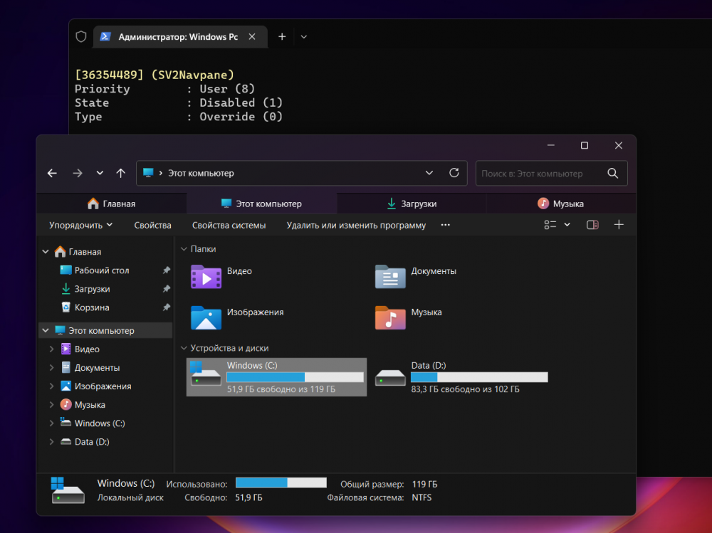

barchee Posted October 22, 2022 Posted October 22, 2022 (edited) On 10/19/2022 at 9:18 AM, barchee said: Also is there any way to revert the navigation bar look to pre-22H2? This big a** thing looks horrendous. UPD: I mean to get the pre-22h2 look, without turning the full compact mode on, like here: I tried to do so using ViVeTool: vivetool /disable /name:SV2Navpane but apparently it doesn't seem to work anymore UPD2: If someone's looking for a solution, the ViVeTool command actually works, you simply need to restart the whole system and not just explorer (also make sure you run it as admin, obviously). The tabs will remain and work flawlessly. Still though, it would be nice to have this feature in SAB. Edited October 22, 2022 by barchee
