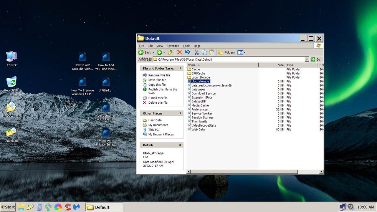

D.Draker Posted April 30, 2022 Posted April 30, 2022 17 hours ago, XPerceniol said: Will have to go back and read it seems and yes evil and bad, but what to do we need Chrome as FF is just not cutting it nowadays. I still use Serpent but many sited don't even load anymore that used to only a month ago and things are changing very quickly. Just replace the folder you don't want with an empty file (WITHOUT extensions) , like on my screenshot. Solved. The same goes to any unwanted files , but in this case you'd need to replace it with an empty folder with the same name. Example 1. You don't want file douchbaggie.exe . Delete it and place there a folder called douchbaggie.exe (with the extension). Example 2. You don't want folder douchbaggie Delete it and place there a file called douchbaggie (WITHOUT extension) . 1

XPerceniol Posted April 30, 2022 Posted April 30, 2022 (edited) 3 hours ago, D.Draker said: Just replace the folder you don't want with an empty file (WITHOUT extensions) , like on my screenshot. Solved. The same goes to any unwanted files , but in this case you'd need to replace it with an empty folder with the same name. Example 1. You don't want file douchbaggie.exe . Delete it and place there a folder called douchbaggie.exe (with the extension). Example 2. You don't want folder douchbaggie Delete it and place there a file called douchbaggie (WITHOUT extension) . Wow ... that seemed too easy, but it def worked - thank you for your help Now, I know my browsing habits area different from others, but I was able to only keep the following after cleaning everything (I save nothing) and the browser works (for me) with only the following needed folders to run (after the loader deletes upon close). Of course, I'm on V11 and its not the same as your V13. V11 runs on less for me and is slim, but I know not for everyone here. I created a fake [User Data\Default\Local Storage] leveldb empty file. For the record: The ONLY 3 files I DO keep are.. User Data\Local State User Data\Default\Web Data User Data\Default\Preferences Edited April 30, 2022 by XPerceniol
