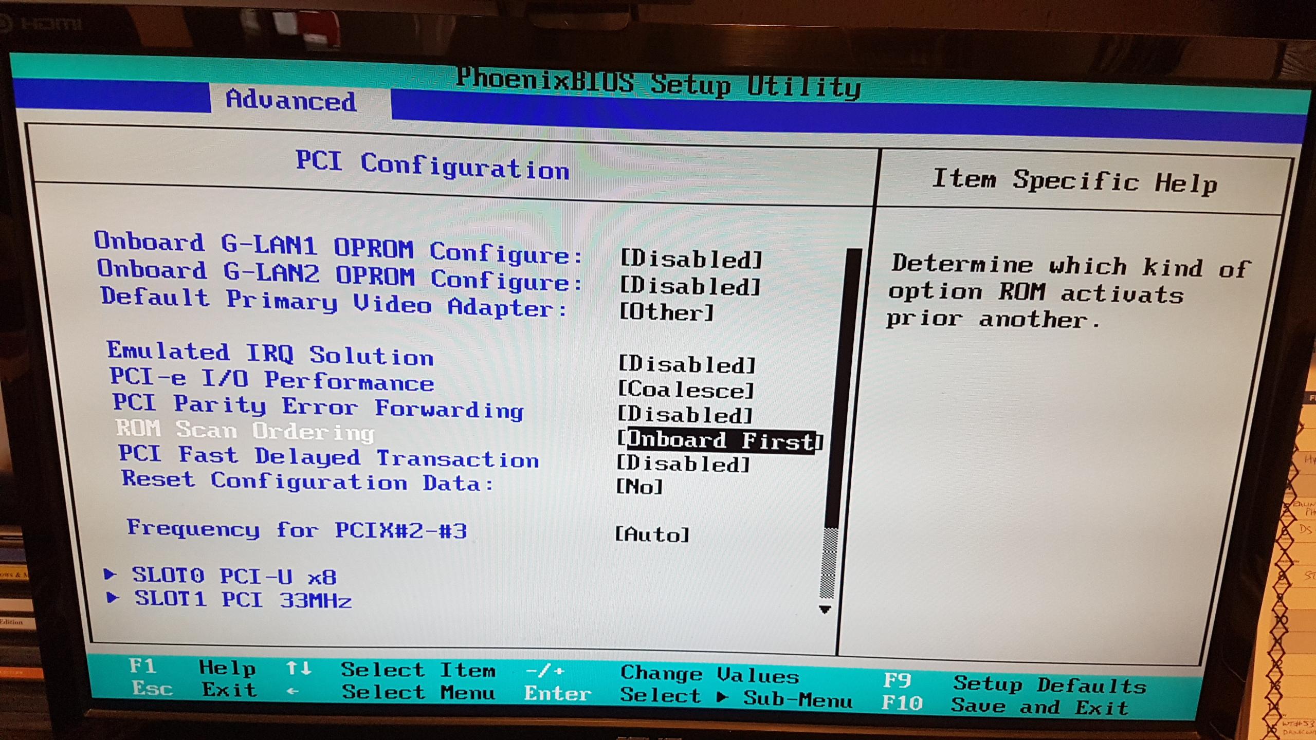

Dave-H Posted February 20, 2024 Posted February 20, 2024 18 hours ago, Andalu said: If I didn't look wrong, I read in your motherboard user manual that there are two options in the bios: "Option ROM Scan" and "ROM Scan Ordering". In order to get the Blu-ray player connected to the asmedia card as a boot device, do you have already set the first option on "Enabled" and/or the second on "Add-On first"?I'm asking just to make sure we've tried every possibility for your motherboard. This is what I have in my BIOS. The ROM Scan Ordering is set to 'Onboard First' as you can see. The other option is 'Addon First'. There doesn't seem to be an 'Option ROM Scan' option in my BIOS, but the BIOS options can change of course depending on the configuration of the machine, type of processor etc. I haven't tried changing the option. I did try as an experiment connecting the Blu-ray drive to the eSATA port on the other Silicon Image card in the machine, the one I used to connect the external disk enclosure to. To my surprise, it wasn't recognised at all, it was like it didn't exist! No sign of it in the BIOS still, and not in the XP Explorer or Disk Management. I didn't try in Windows 10, but I guess the result would have been the same. I tried updating the driver in XP using the one on the disk which came with the card. It went through the motions and then said 'Windows cannot open this program because it has been prevented by a software restriction policy.' I don't know what to do about that. 2
