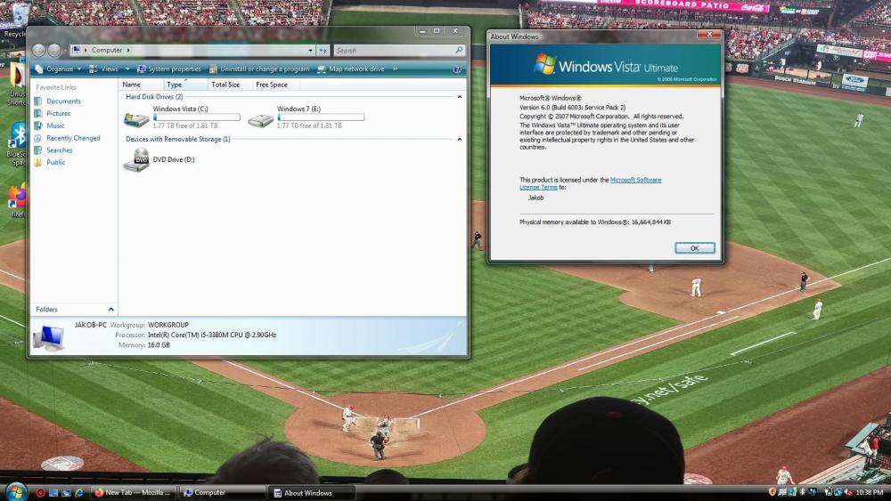

Jakob99 Posted October 4, 2021 Posted October 4, 2021 3 hours ago, ScrapMechanicFan2016 said: all i did was modify a commandline tool that exists for Volume License versions of Office 2019 so i could install Retail Microsoft Office 2019 Home and Student. and yes there is a version check. but its the same one Office 2016 uses. so in theory office 2019 can be installed on Windows 7 Without NT Version Spoofing. i just havent had luck with it. when i tried on server 2008 Office 2019's installer said it needed Windows 7 or newer(despite Microsoft's official OS requirements saying Windows 10) meaning POSSIBLY it can be installed and run on Windows Vista/Windows Server 2008 with the next Extended Kernel Release(i think. win32 did say in a previous post that NT Version Spoofing will be in the next extended kernel release iirc) I sure hope so! Also, I am here to say that I am returning to Windows Vista complete with a dual-boot of Windows 7. The reason I left it was because it could not read the full 4TB SSD. This problem is no more thanks to this tutorial: https://vinaypundith.github.io/windows_7_efi_guide/ Thanks to K4Sum1 over at Eclipse for digging this out. This should allow Windows Vista UEFI on newer UEFI devices like Sandy/Ivy Bridge, Haswell, etc (basically those processors that have Windows 8 and later support). You get safe mode and anything else that requires basic display as that is not removed and is left intact. This will also allow for Vista installation on Class3 UEFI devices such as the Acer Spin 5 where Legacy mode is unavailable. It also allows for 4TB or greater HDD/SSD's as well. All that is left to marry this setup together is Windows 7+ driver support and hopefully a fix for the Haswell+ issues. Regarding driver support, win32 told me at betawiki discord that he encountered some issues with getting it working and decided to put that on the back burner for now. Not sure what all is needed to get that working properly, but would be nice if someone with unsupported hardware could help out and see if they can help win32 get it working. @win32Not sure if you know about being able to use UEFI7 under Vista. I did so and it worked just fine. 2

Jakob99 Posted October 5, 2021 Posted October 5, 2021 (edited) Alright, I got Windows Vista and Windows 7 dual-booted under UEFI mode thanks to UEFI7. Like I mentioned above, UEFI7 will allow for Windows Vista to run on newer UEFI modes (anything that supports Windows 8 or later such as Ivy/Sandy Bridge, Haswell, Broadwell, Skylake, etc). This will also work with Class 3 UEFI mode, which is seen on some computers such as the Acer SPIN 5. Due to the lack of Legacy mode, UEFI is required. I do not recommend Windows Vista on newer systems until Windows 7+ driver support is worked out, which will be awhile. Once again, here is the link to learn how to do this: https://vinaypundith.github.io/windows_7_efi_guide/ Edited October 5, 2021 by Jakob99
