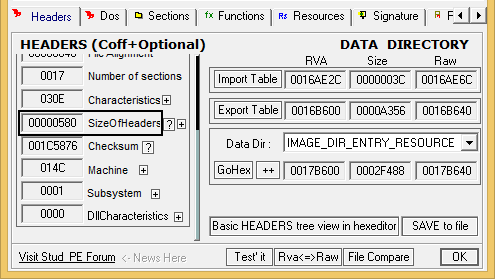

Ximonite Posted May 27, 2020 Author Posted May 27, 2020 (edited) 2 hours ago, win32 said: Why don't you try Stud_PE? Thank you for the suggestion. It works exactly how I need it to except for one thing. The one thing is that after adding a section, the Import Address Table Directory RVA is invalid. Is this important? If it is, does anyone know a way to fix this? Edited May 27, 2020 by Ximonite spelling error

win32 Posted May 27, 2020 Posted May 27, 2020 (edited) 12 hours ago, Ximonite said: The one thing is that after adding a section, the Import Address Table Directory RVA is invalid. Is this important? If it is, does anyone know a way to fix this? What tool states that it's invalid? My test modifications seem to be fine with CFF Explorer and stud_pe. I don't know much about this stuff, but putting the new sections at the end shouldn't affect the sections before it, I think... try maybe adjusting the virtual offset of the section that corresponds to the import address table? We should page @blackwingcat since he would obviously know about this stuff. Edited May 27, 2020 by win32
Ximonite Posted May 28, 2020 Author Posted May 28, 2020 13 hours ago, win32 said: What tool states that it's invalid? My test modifications seem to be fine with CFF Explorer and stud_pe. I don't know much about this stuff, but putting the new sections at the end shouldn't affect the sections before it, I think... try maybe adjusting the virtual offset of the section that corresponds to the import address table? CFF Explorer stated that it was invalid. I figured out that I need to change the value of the Import Address Table Directory RVA to the same value as SizeOfHeaders. 1
