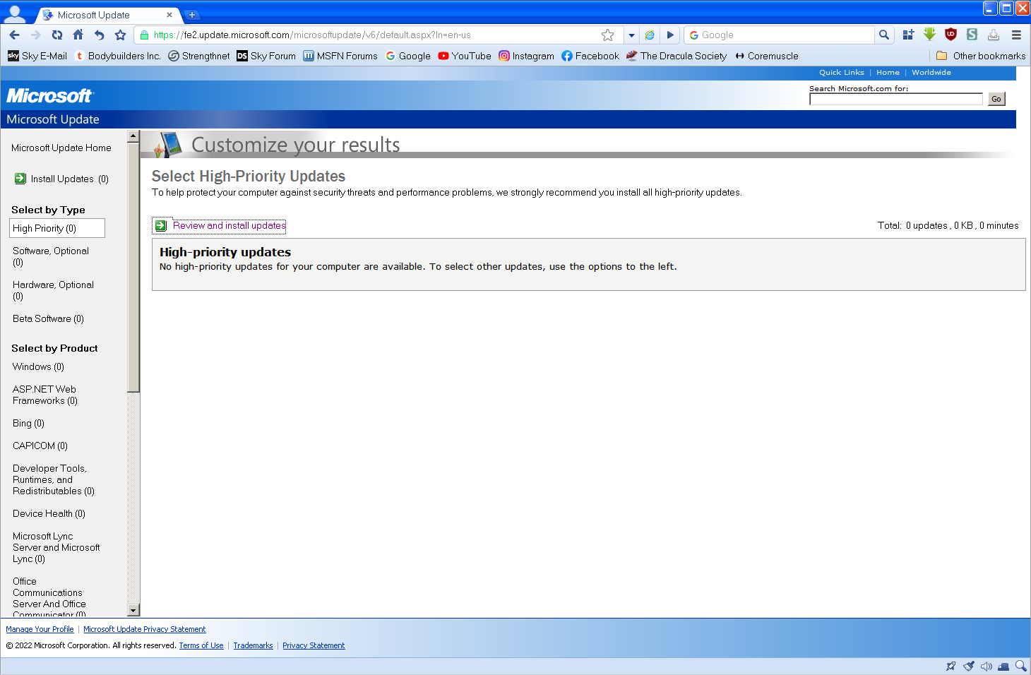

50 minutes ago, Dave-H said:
Just for completeness, now working fine in 360Chrome 13.5.
:yes:
