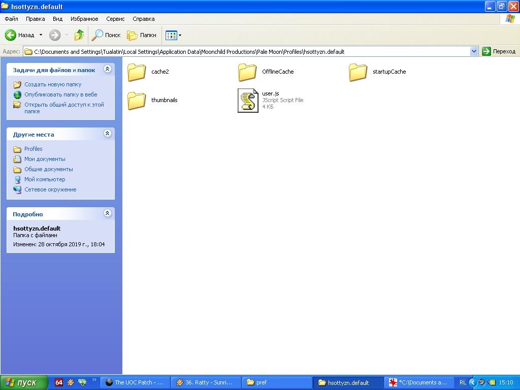

S75 Posted October 31, 2019 Posted October 31, 2019 (edited) Hello, first thanks for developer of this patch, its very good that some one do optimization stuff for old (and cool) machines. And now the issue)) How i can test performance and speed up of this patch in system without placebo effect ? I have P3 tualatin 1400@1600mhz 512mb ram and GF 5900xt card OS windows xp3 pro Sp3. And i don't see any different bitwine stok, mb little bit smoother. Maybe i dont intall it right i dont know( i just copy file in directory show on screen). Test in new moon 27 and firefox 45 esr. And i install all extension that recommended in first post. Edited October 31, 2019 by S75
looking4awayout Posted October 31, 2019 Author Posted October 31, 2019 (edited) Hello and thank you for your feedback! First, I have to ask you if you have installed the UOC Patch for Firefox 45 ESR in the proper folder (defaults\pref). The Enforcer has been installed in the wrong directory. As @VistaLover correctly pointed out. Did you start with a clean profile? If you already modified the prefs.js in the past, there might be some issues. Also, the FX5900XT is quite borderline in terms of minimum requirements and so, the improvement in graphics acceleration might be minimal compared to say, a Geforce 6800GT. The driver version matters! On the 6800GT, Forceware 81.98 gives a much better performance with the UOC Patch. I'm not sure which Forceware version runs better with the FX series. Usually, the most effective way is to directly compare the performance between unpatched browser vs. the patched and enforced one, starting from a clean profile. That might give you a better idea of the performance improvement. I am working on a new version of the UOC Patch, I might release it today if I have the time. Once done, please update. Edited October 31, 2019 by looking4awayout 1

VistaLover Posted October 31, 2019 Posted October 31, 2019 (edited) 12 hours ago, S75 said: Maybe I didn't install it right, I don't know ( I just copied file in directory show on screen) Methinks the UOC Enforcer file (user.js) hasn't been correctly installed, as both directories depicted are not the main profile directories of either New Moon 27 nor FirefoxESR 45! Page 1 of this thread says: On 4/3/2019 at 4:35 PM, looking4awayout said: In order to install the UOC Enforcer, you must put the user.js file into your Firefox/New Moon/Pale Moon/Sea Monkey profile folder, that you can usually find at C:\Documents and Settings\User\Application Data\{Your Browser}\{Browser Name}\{Profile Folder} on XP To easily locate your main browser profile folder, use the browser's about:support internal tab, from there "Application basics" => "Profile folder" => "Open folder" button... E.g. for FxESR 45 it should be located at: "C:\Documents and Settings\Tualatin\Application Data\Mozilla\Firefox\Profiles\e0afyh62.default" Regards Edited November 1, 2019 by VistaLover 4

S75 Posted November 1, 2019 Posted November 1, 2019 On 10/31/2019 at 5:23 PM, VistaLover said: To easily locate your main browser profile folder, use the browser's about:support internal tab, from there "Application basics" => "Profile folder" thanks this help. Think need add this information in first post for more careless users like me, because in first time i don't find original folders :\ On 10/31/2019 at 3:25 PM, looking4awayout said: Did you start with a clean profile? in first case no. But after you post clear both browsers NM27 and FF. On 10/31/2019 at 3:25 PM, looking4awayout said: Also, the FX5900XT is quite borderline in terms of minimum requirements Lol it's even upgrade card in first time i test vs GF2 m400 and hope to see any speed ups)) (i know that required dx9 card, but hope do some test mb even GF2 work) On 10/31/2019 at 3:25 PM, looking4awayout said: the improvement in graphics acceleration might be minimal compared to say, a Geforce 6800GT. Luckily i have GF 6800 and now test with it and install Forceware 81.98 driver like you say. On 10/31/2019 at 3:25 PM, looking4awayout said: Usually, the most effective way is to directly compare the performance between unpatched browser vs. the patched and enforced one, starting from a clean profile. That might give you a better idea of the performance improvement. Test stock browser NM and FF vs Patched. Patched version of both is real smoother and faster. Thanks. 2
