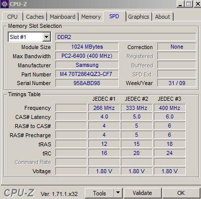

Here are the SPD's:
post-80608-0-30149700-1420143628_thumb.j  post-80608-0-65849700-1420143640_thumb.j
both 2Gig are identical and are; Hynix 2GB 2Rx8   PC2-6400S - 666- 12         HYMP125S64- S6 AB
the 1Gig reads                     Samsung 1GB 2Rx16 PC2-6400S - 666- 12 -A3   M470T2864QZ3-CF7   0931

The SPD looks good. The only reason I asked for it was because you can run into RAM sticks that are re-labelled. ;)
