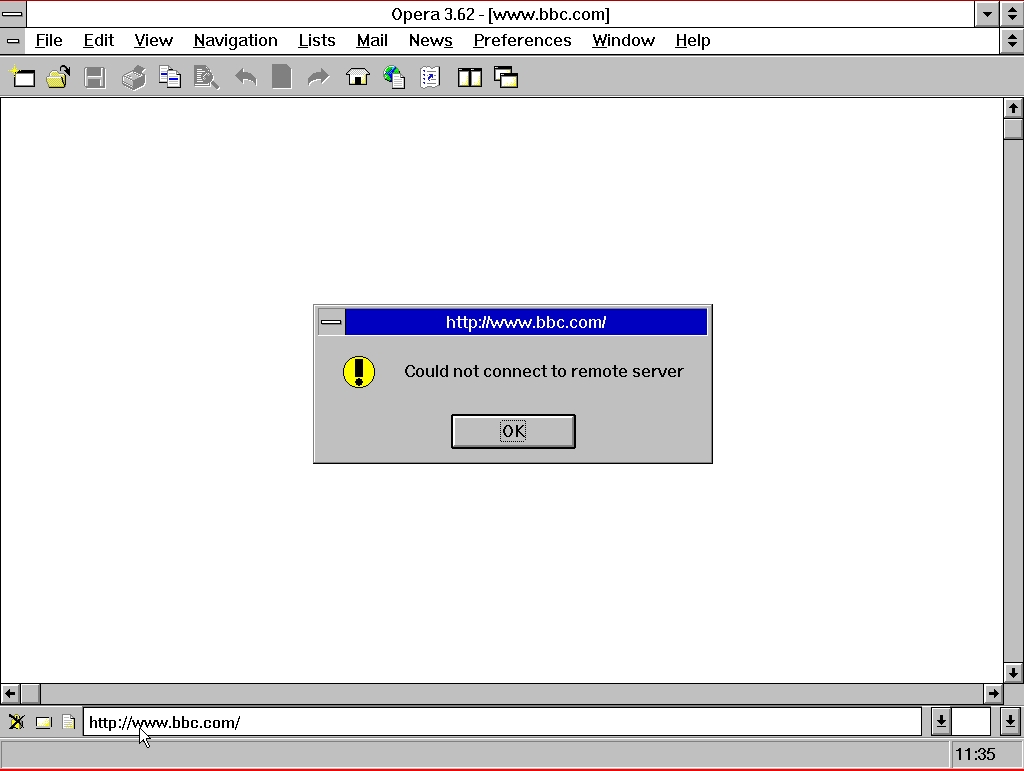

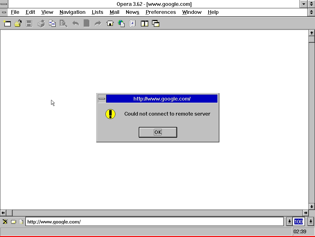

shelby Posted January 19, 2023 Posted January 19, 2023 58 minutes ago, deomsh said: I have only experience on Windows 3.1 (so NOT WFW 3.11). Browsers: best is Netscape 4.03 or 4.04, using a proxy server or a webproxy. Without: Netscape 3.04. Watch a-synchronous DNS. More details here (go to page 2): https://web.archive.org/web/20180329130629/http://win3x.conforums.com/index.cgi?board=net&action=display&num=1517876379 In win 3.11 there is no need for share command because of the winsock.dll. The ie5 put his installation folder in path command. Every browser needs trumpet to run first to enter the internet except ie5

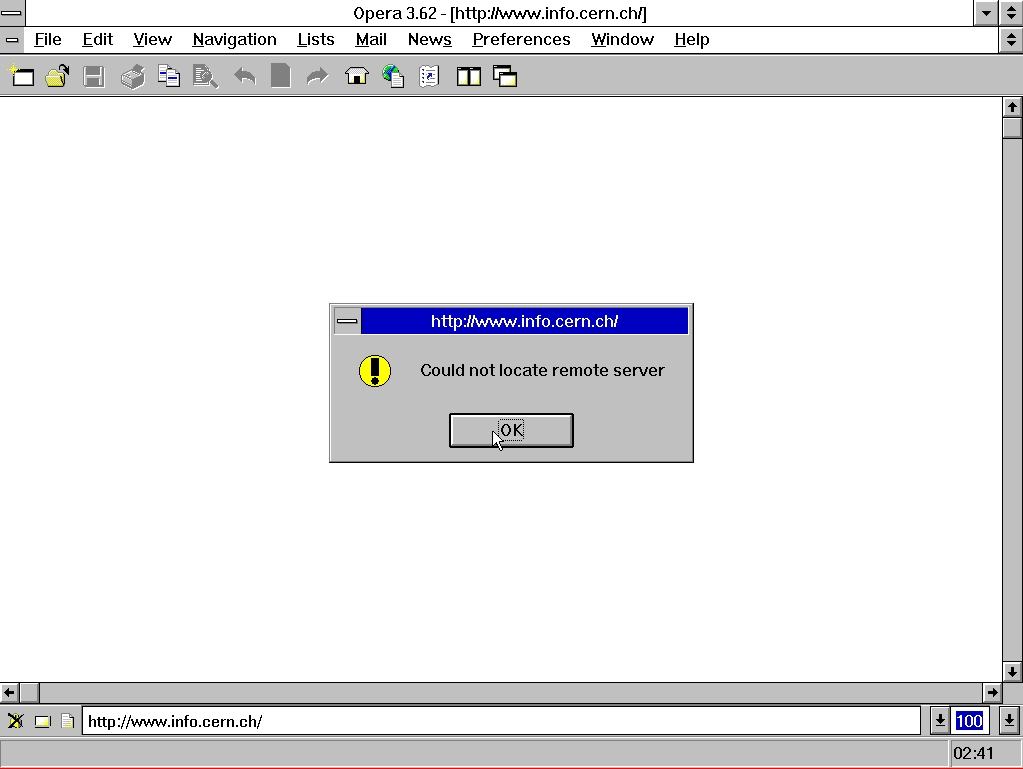

jaclaz Posted January 19, 2023 Posted January 19, 2023 bbc.com redirects to https, that may be (part of) the issue. Try: http://info.cern.ch/ jaclaz
shelby Posted January 19, 2023 Posted January 19, 2023 (edited) nothing Edited January 19, 2023 by shelby

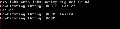

shelby Posted January 19, 2023 Posted January 19, 2023 (edited) for the links browser Edited January 19, 2023 by shelby
