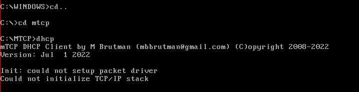

Is this in a "Windows" MsDos Prompt, or Real Dos Prompt?
You want to be using a Windows Prompt.
Edited by awkduck

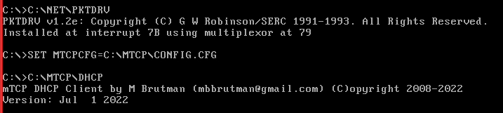

If you have rebooted, then you need to run PKTDRV and make sure that the installed interrupt is the same as in "C:\MTCP\CONFIG.CFG"
Posted (edited)
it is the same. i made a net.bat that runs in windows promtp

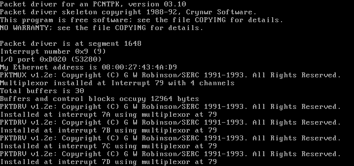

Edit autoexec.bat and add a PKTDRV for every channel you need.
PKTMUX 8 79
PKTDRV
PKTDRV
PKTDRV
PKTDRV
PKTDRV
PKTDRV
PKTDRV
PKTDRV
Reboot but do "not" start Windows.
Examine "all" the PKTDRV installed interrupts.
Once you have them written down, or something, start windows.

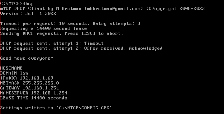

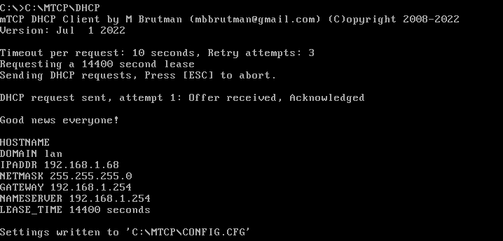

To test if it is working, make sure Tumpet is running and run DHCP.EXE.
You should now see DHCP report a different I.P. then Trumpet.
If you never end up using all channels, you can reduce them to save memory.
#AUTOEXEC.BAT
PKTMUX 4 79
PKTDRV
PKTDRV
PKTDRV
PKTDRV
That is now working like it should.
Will your firewall prevent the new I.P. addresses from working, like before?
Notice, that DHCP now gives itself a different I.P. then Trumpet. Which is the way it is supposed to work.
Each channel "should" request it's own I.P..
