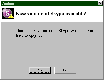

Andrew T. Posted October 4, 2013 Posted October 4, 2013 Does anyone know if a Windows 95-compatible version of Skype exists...or ever existed, for that matter?I do know that the early 1.x versions were compatible with Windows 98. No luck experimenting with those, though. If I so much as run the installer, this charming dialogue is the first thing to appear:
LoneCrusader Posted October 4, 2013 Posted October 4, 2013 If that is the first thing to appear, it suggests that the installer is automatically checking for updates. Have you tried running the installer while not connected to the Internet?
Andrew T. Posted October 4, 2013 Author Posted October 4, 2013 Yep. That just appears to make the installer hang and require a force quit when it does its automatic checking. Now I'm dying to hack the installer, though. I poked around it with Resource Hacker and a hex editor, but didn't see anything that was an obvious version check.

Steven W Posted October 4, 2013 Posted October 4, 2013 (edited) Got the version I mentioned above working (1.3066)hint:127.0.0.1 ui.skype.comNot sure if that will let the installer work, if it will work on Win95. If the installer won't work, disconnect from internet and install.Edit: This does let the installer work, but now I can't log in? I'll keep poking around.Further edit: It does work, I'm putting all the steps I've taken here, not sure if everything is necessary, but...1. Download the version I have linked to above2. Disconnect the PC from the internet3. Run the installer, it may hang for a minute, but will eventually run.4. Reconnect the PC to the internet.5. Start Skype, you will see the ugly update box, tell it yes or no (doesn't matter)6. Add line to hosts file and reboot7. Start Skype and enjoy. Edited October 5, 2013 by Steven W
