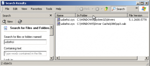

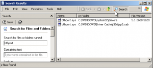

Just did a full test run earlier and so no issues with those files and nLite. See images...
post-12166-0-50297900-1382130678_thumb.p
post-12166-0-85387100-1382130702_thumb.p
