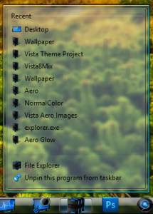

OK no worries, well if you like you can check out a new theme I just posted with a transparent jump list http://mrgrim01.deviantart.com/art/Vista8Mix-369583696 download from mediafire http://www.mediafire.com/?u85k16nhg1heg46
Updated to fix missing taskbar image and text centered on title.

OK no worries, well if you like you can check out a new theme I just posted with a transparent jump list http://mrgrim01.deviantart.com/art/Vista8Mix-369583696 download from mediafire http://www.mediafire.com/?w3q9k7riis9vm9o
thats more than good - i have a problem with the taskbar - the graphic you have added does not go all the way across - its behind the SIB button and the right icons - centre is missing - guess its me but no idea what to look at
i see you have moved text to the left on the top bar - is it easy to put back to centre - a setting or a reg key - just personal preference
but if i can sort the taskbar thats me pretty happy
Sorry mate, I fixed those problems, uploading again now.
still not working for me - not sure i am downloading newfile - all file sizes are the same
and my other question about moving text back to centre??
Nope you were downloading the old one again most likely, new link is http://www.mediafire.com/?u85k16nhg1heg46

sorted thanks - i was too quick - the taskbar mod makes it perfect for me - i can now do more with the windows aero - previously making that dark made the taskbar too dark but this cures that
