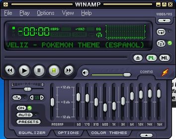

But I wanted (and omitted in my previous post) to ask you, with all the multitude of volume settings, how should I set the volume on each component ? I have volume on music player (in this case Winamp), on sound card (two in fact, for general output and headphones output) and on both active speakers and receiver (depending of what am I using).
I typically like to leave Windows at its defaults and use only 1 software method for controlling sound. So for my PCs I let Winamp handle the EQ, and the Creative (or other) software not enable any EQ or other effects.
