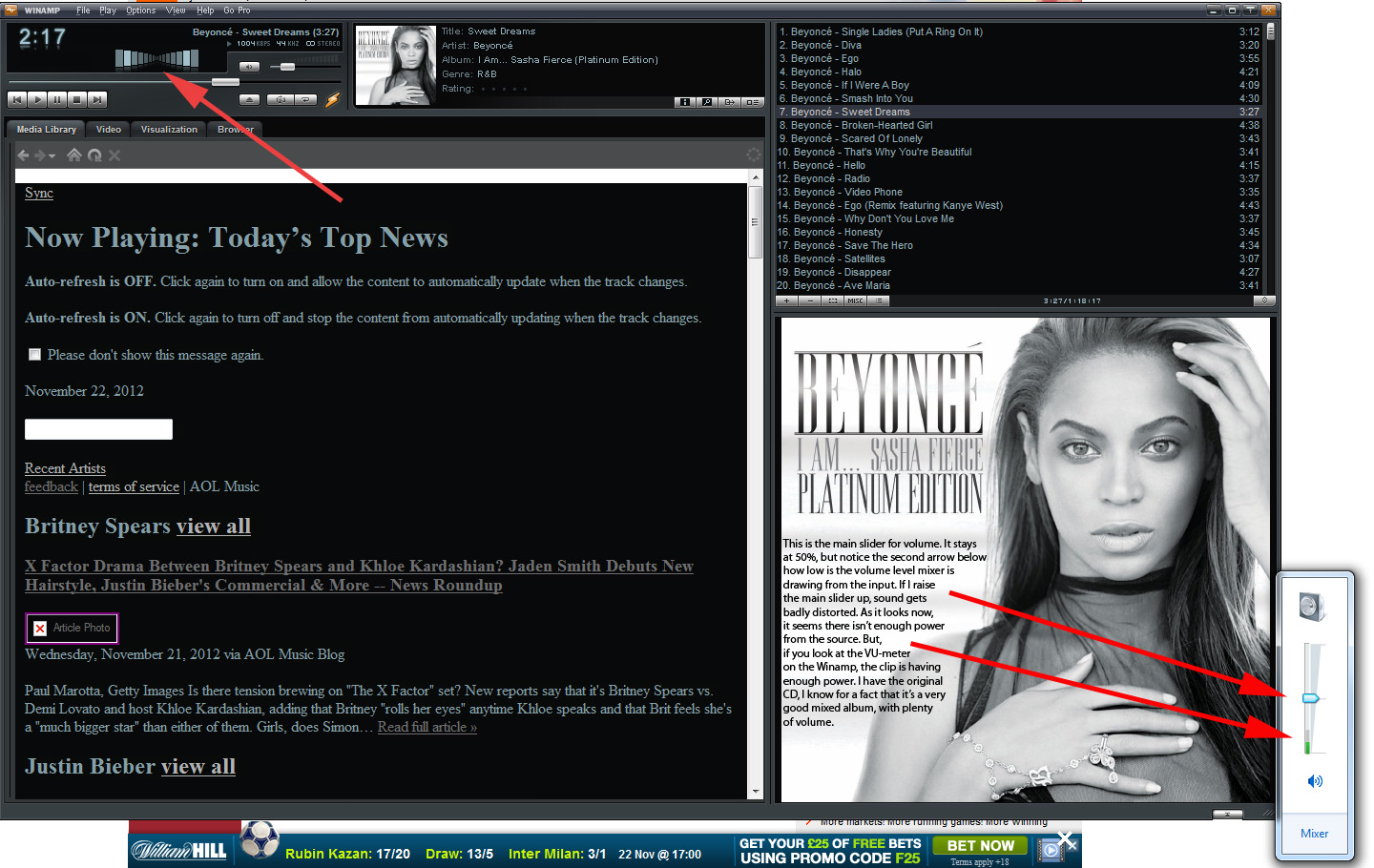

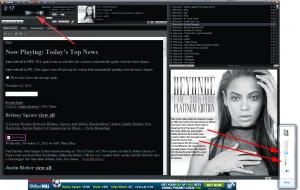

Edit: I downloaded a third party VU-meter and sound level is at -10 dB at max, I believe it's way too low, don't know if that's what is causing problems or not.
post-363572-0-87107400-1354119921_thumb.
Edited by Phaenius
To the right of the top-left-most arrow is the WinAmp Mute button and then a Volume slider. You have the slider set very low. To get more volume, slide it all the way to the right and Pump Up the Volume! :yes: Then turn down the volume at the speakers until it doesn't distort. B)
In the picture, the VU meter pointed to by the arrow show no color and appears to also be indicating low playback volume being sent to the system mixer. Press Alt+G to check WinAmp's internal equalizer and preamp levels.

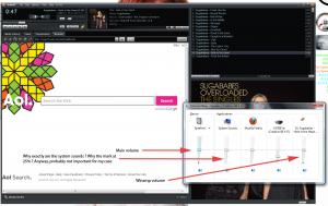

>Another thing is the Windows 7 mixer (which I don't get it). I attached a picture.
Are you saying that clicking on the Mixer button at the botton of the System Volume control does nothing? Try double-clicking on the Volume control in the systray to open the mixer.
Once you find the system mixer, report the levels found there. Make sure you select all volume controls in Options->Properties.
Well, I tried that, trust me, I tried everything. This is the highest setting in Winamp volume that doesn't cap. If I move the slider to the right (higher volume), sounds doesn't get higher, low frequencies get cut altogether, only mediums and high pass by and, at rich sound (lots of instruments, voice, etc.), it gets heavily capped, I mean, if someone is progressively yelling let's say, volume stays the same, sound card is clipping the sound. If I move the Windows mixer up, sound get heavily distorted, especially at bass levels.
I did checked. It's at default. If I raise the preamp, sound gets distorted. EQ is flat. Mostly because I set the EQ from the Windows mixer and/or external amplifier or active speakers.
You should also explore the Audio tab of the Multimedia Control Panel, especially Playback: Advanced Settings->Performance.
Sure it does. I attached a picture to this post with the levels, with annotations. Volume levels are low, if I raise them, sound gets either capped (clipped) or distorted.
