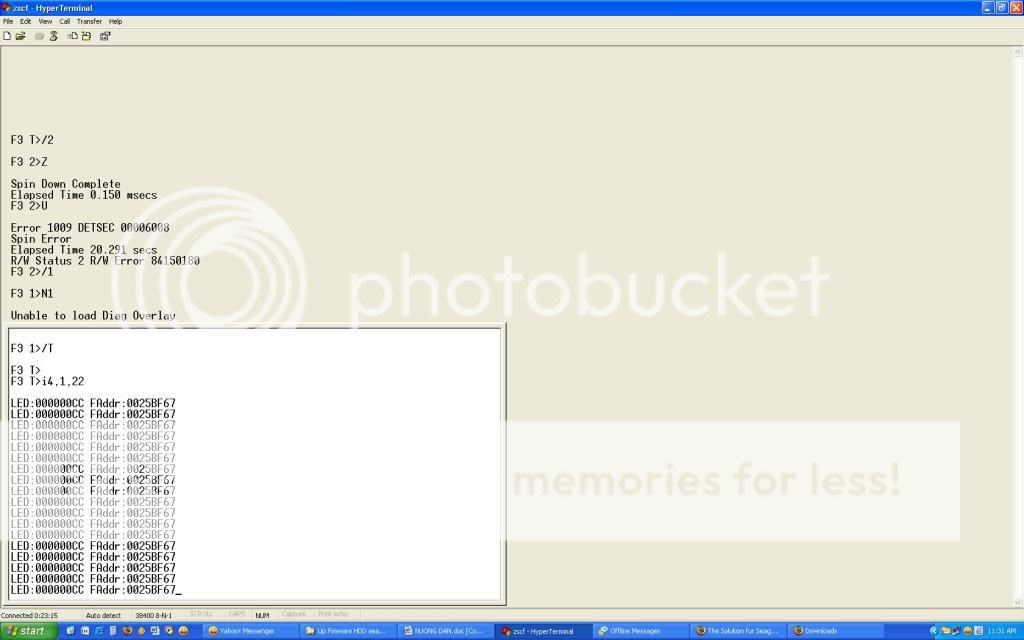

Hi all . please help me this error. Have failed to board ?
Yahoo: hoiphucdulieu
Gday mate ..it appears that you did not lift the pcb board off of the PCB that touch the hdd motor contacts ok
im not an expert but i seem to remember that this was the error you would get under normal operation in hyperterminal... undo all the screws on your circuit board(PCB) on the hdd so that they are only just holding on the PCB then slide a piece of paper under the PCB where the contacts are for the hdd motor (in the centre of the hdd) then screw them back down this should rectify your problem .. read other threads in here and click their links to photos and other useful bits of info to give yourself a better understanding of what is being done, if your english is bad have a friend help u with translation .... follow Gradius2 instructions to the letter

thank you
I have done the right steps,but still this error.( error 1009 detsec 00006008 )
CODE
F3 T>/2 (enter)
F3 2>
And type (to spind down the motor):
CODE
F3 2>Z (enter)
Spin Down Complete
Elapsed Time 0.147 msecs (the time will vary here)
F3 2>
With the POWER CONNECTED to the PCB board, as well as your TX/RX terminal wires, mount the board back on the HDA case. You must have the power connected when you do this.
Now type (to start the motor):
...................... v.v
