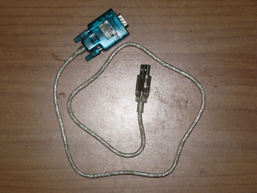

I just bought this convertor, is it good to solve the issue ? What else do I need ?
Thanx !
Yes, it would be advised.
Thanx !
You have a USB to Serial port adapter.
You need a RS232 serial port adapter logic levels to TTL / CMOS 5V or 3.3V, also.
