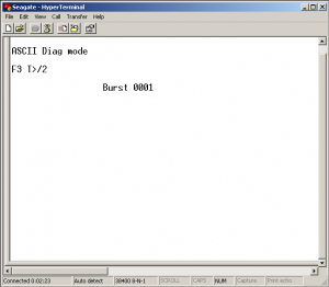

I can connect to the drive 100% when I hit Control-Z, the problem comes in when I try to spin the drive down. I get this error. ( file attached )
Can someone please assist? I really need help here! :blink:
thanks in advance!
sorry I was doing something really stupid.. :whistle:
Thats another drive back from the dead!
:thumbup:thumbup:thumbup

Hey folks, nice work here. Myself, I completed each step but now when i did the m0,2,2,,,,,22 command, it has sat here for more then 20 minutes with no confirmation of completion. Anyway to cancel it and try again or should I just shut off the drive and try again?
dude im pretty sure it says that if you turn the drive off at that stage then you land up with a brick, and there is no going back!
keep the power on, and I would start from the beginning. What happens if you hit Contolr-Z ?
I would just start again, and include the "optional" bit

I can't do Ctrl+Z or anything, it is just sitting there. I guess I'll just leave it on, it is 1:30AM in my area right now, I'll check back when I wake up to see if anything can be done (I hope so!).
Posted (edited)
ok so it's been 8:30 hours and still no completion message. Any safe course of action at this point?
The only thing I can think of is disconnecting via hyperterminal and reconnect.
Welp I tried it and it seems to be stuck in whatever state after i initiated the m0,2.... command. Damnit.
For those that care and may encounter the same problem, I ended up searching this thread one more time and it turns out someone had the same problem as me. The solution: I powered down and started the process over again. It worked.
