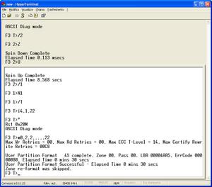

i've a barracuda 7200.11 ST31000333AS hard drive which had the busy issue.
I was able to fix it with the rs232/TTL adapter and hyper terminal.
I repaired baracudas 7200.11 in the past with the same problem, but i hade different message in hyper terminal.
This barracuda has lc15 firmware had the orrible tick tick head noise which made me fought that the issue was in dead heads (not the firmware), but for curusity i tried to do the firmware fix and it worked, no more tick ticks and bios recognize it again :thumbup
So no bad heads! :lol:
The strange message i had in hyperterminal for the ST31000333AS, was at the end which says "Zone re-format was skipped"
It never happened with barracudas.
It's normal?
Barracuda 7200.11 ST31000333AS firmware LC15 (BUSY error + ticking heads)
But the "Zone re-format was skipped" wasn't the only strange thing!
As yuo can see in the pic i had at the begin the "ASCII Diag Mode" message which i never had with the barracudas procedure.
Another difference between this and the others barracudas was the time it took to format the user partition; barracuda usually take's about 2 minutes, some time few seconds, but this one take about 5 minutes.

It's normal?
Hard to say. :blink:
It may depend from some differences in firmware, but I think it has to deal with the fact that you didn't actually "fix" the issue with it's "proper" cure, I mean, unlike the "classical" fix, which is the fix for a given illness, in your case the procedure worked as a side effect, very like the note in read-me-first::
Notwithstanding the above, this info may be useful to solve a number of similar problems on a whole range of similar hard disks, but in this case information here needs to be checked and verified if applies to your different HD.
In other words your mileage may (and WILL) vary.
Viewing the results and reports on this thread, the procedure is starting to look NOT as a "full reset" of the disk, meaning that it is not a "complete initialization", but rather a "partial one", or if you prefer something like a "warm boot" as opposed to a "cold" one.
Just hypothesys, mind you, but it is possible that when the firmware gets into a LBA0 or BSY state a "flag" or "registry" or whatever is set in such a way that when the "m0,2,2,,,,,22" command is issued, the zone-reformat is NOT skipped, whilst when a completely different kind of problem happens (such as the ticking heads) this flag is reset to "skip zone re-format".
Think at it just like the "dirty" bit that triggers (or triggers not) autoochk/chkdsk on NTFS volumes. :unsure:
About the time needed, there are reports ranging from a few seconds to several minutes, so that appears "normal" (within the limits of our partial knowledge/experience).
To this you add that we don't know WHAT actually happens during this time as we don't actually know the actual status of the disk before the fix, expecially when the fix is used as a solution to a non-LBA0 and non-BSY issue.
jaclaz
Edited by jaclaz
