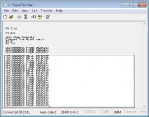

Hi, I hope someone can help me here and I will be very appreciated. I have done all the procedures on the link but when I try the U step(Spin up the motor) I will get another message like an error and it repeats that row of error in highper terminal. A picture of this is attached. Any idea what can cause that error?
Thank you in advance
Kind regards
Mehdi

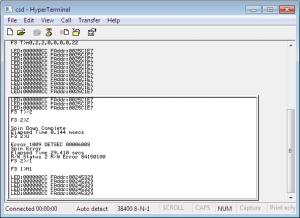

Sorry, I attached wrong picture from highper terminal in my previous post.
this is the right one.
Thanks
I might not be able to help you, but you should rule out the possibility that the PCB has been connected to the disk (motor/head contact not isolated), by completely removing the PCB, put it on an isolated surface and try the Z/U commands again. If you still get your specific error, my guess is that you have a more severe fault than the regular BSY error.
