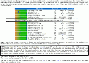

TerTop Posted January 11, 2009 Posted January 11, 2009 I have a 7200.11 500GB, firmware SD15, OEM class, purchased around March 2008 has been running fine all along. Im thinking maybe its the configuration that triggered the firmware mess up? Anyway here is what happened to me:a) running on Intel ICH9R but in AHCI mode. Jumpered the drive to SATAII 3Gb mode. When transfering large files between drives, system slow down to a crawl and after a while back to normal. The cycle keep on repeating until the transfer completed. Event Viewer gave me a lot of errors something like "The driver detected a controller error on\Device\Harddisk0\D". The drive was jumpered back to SATAI 1.5GB mode and has been running fine since. Im thinking maybe the constant error in SATAII mode might confuse the SMART and eventually made it corrupted?On another issue, my SMART health has a warning on the over limit of START/STOP count status. Could it be an early sign to the SD15 death curse?

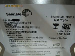

DerSnoezie Posted January 11, 2009 Posted January 11, 2009 (edited) To all seagate barracuda 7200.11 SD15 (and other version) owners, either broken down (by "no detect in bios", 0GB reported disc size & "the click of death") or still functioning fine, who are reading this topic:Please register to this forum and add your data to the list below so we can take a stand against seagate corporate practices. Moderators on the official seagate forum claim that our problems are not statistical significant, but judging from numerous complaints spread out over the internet we think they are! However, without a serious dataset (1000+ cases, from different countries) we don't stand a chance proving it statistically wise. So please help by adding your data.Most of the data can be collected from the sticker on the top of your harddrive (please keep in mind that you preferably do this when the computer is powered down, be safe). If you are afraid that seagate will "blacklist" your drive, then only add the first 3 or 4 characters of the serial number. We will use a simple seagate date code calculator tool to translate the 5 digit code listed on your harddrive to the date it was manufactured. Thanks for your time and spread the word! Number:Serial N°:Model:Part N°:Firmware:DateCode:SiteCode:PurchaseDate:FailedDate:OEM/RETAIL:UserName:Country of the User:reason of failing / still running fine==============================================================================================================01:9QM7VZBP:ST3500320AS:9BX154-303:SD15:09146 (09/Oct/2008):KRATSG:Oct2008:24Dec2008:poolcarpet:Malaysia02:9QM6X90B:ST3500320AS:9BX154-303:SD15:09115 (17/Sep/2008):KRATSG:Oct2008:28Dec2008:DaftMule:United Kingdom03:9QM6W2JE:ST3500320AS: - :SD15: - : - :5Dec2008:19Dec2008:DerSnoezie:Netherlands (no detect in bios)04:9QM4G4PK:ST3500320AS:9BX154-303:SD15:08503 (16/Jun/2008):KRATSG:Aug2008:Nov2008:dskbrk05:9QM3RWHJ:ST3500320AS:9BX154-568:SD81:08464 (20/May/2008):KRATSG:Aug2008:23Dec2008:ToKuRo:Chile (no detect in bios)06:9QM7KSQJ:ST3500320AS:9BX154-501:SD15:09134 (30/Sep/2008):KRATSG:28Oct2008:07Jan2009:jeroen__online:Netherlands07:9QM2MFS6:ST3500320AS:9BX154-303:SD15:08406 (10/Apr/2008):KRATSG:12Apr2008:23Dec2008:quattro150:Malaysia08:9QJ0XJ01:ST31000340AS:9BX158-303:SD15:08496 (12/Jun/2008):KRATSG:Aug/Sep2008:8Jan2009:Nichev09:9QM717SF:ST3500320AS:9BX154-303:SD15:09114 (16/Sep/2008):KRATSG:13Oct2008:14Dec2008:PrOdiGy1:UK10:9QJ1LESR:ST31000340AS:9BX158-303:SD15:09063 (11/Ago/2008):KRATSG:Nov2008:27Dec2008:AVINNC:USA11:9QJ1AGEV:ST31000340AS:9BX158-303:SD15:08515 (2/Jul/2008):KRATSG:Aug2008:4Jan2009:Ruddrage:UK12:9QM6354J:ST3500820AS:9BX134-505:SD25:09084 (26/Ago/2008):KRATSG:July2008:20Dec2008:rainshower:Germany13:9QM33FL8:STM3500320AS:9GT154-325:MX15:08396 (03/Abr/2008):KRTASG:Sep2008:30Dec2008:fabio.cillo:Italy14:9QM*****:ST3500320AS:9BX154-303:SD15:08367 (14/Mar/2008):KRATSG:Dec2007:Dec2008:Death_Angel:Malaysia15:9QK*****:ST3750630AS:9BX146-621:HP24:08511 (21/Jun/2008):TK:Oct2008:7Jan2009:Taiketo16:5QJ*****:ST1000340AS:9BX158-303:SD15:09121 (20/Sep/2008):WUXISG:October2008:28Dec2008:Styleman17:9QM8DRHL:ST3500320AS:9BX154-303:SD15: - (13/Oct/2008):KRATSG:06Dec2008:24Dec2008:roadstarter:Philippines18:9QM6****:ST3500320AS:9BX154-303:SD15:09076 (21Aug2008):KRATSG:15Oct2008:29Dec2008:labraticmp3:USA19:9QM6****:ST3500320AS: - : SD15 - : - : Oct2008:2Jan2008:eli2k20:9QM5****:ST3500320AS:9BX154-303:SD15:09063 (11/Ago/2008):KRATSG:6Nov2008:27Nov2008:poim7621:9QM2CHR4:ST3500320AS:9BX154-303:SD15:08382 (23/Mar/2008):KRATSG:August-08:Nov-Dec-08:caba212:Spain22:9QJ15ZBN:ST31000340AS:9BX158-303:SD15:08496 (05/Jun/2008):KRATSG:July2008:26Dec2008:GrayGhost:USA23:9QM27S5F:ST3500320AS:9BX154-303:SD15:08381:DEC 08:JAN 09: timha24:9QJ0****:ST31000340AS:9BX158-303:SD15:08495:KRATSG:Oct2008:02Jan2009:viniciusferrao:Brazil25:9QM60864:ST3500320AS:9BX154-303:SD15:09076:KRATSG:31 October 2008:Dec 2008:RiderZen:Australia (BSY)26:9QJ0W41R:ST31000340AS:9BX158-335:SD15:08457 (16/May/2008):KRATSG:Jul2008:20Dec2008:Macprk:USA27:9QM5V5HQ:ST3500320AS:9BX154-303:SD15:09071:KRATSG:(04/Nov/08):(09/Jan/09):BigSilverHotdog:USA28:9QM2C4LT:ST3500320AS:9BX154-303:SD15:08382(??):KRATSG:Aug2008:1Jan2009:Keddar:USA29:5QM1EYCG:ST3500320AS:9BX154-303:SD15:08383:WUXISG:jUL2008:02Jan2009:waly2k1:Argentina (no detect in bios).30:9QM5RCNT:ST3500320AS:9BX154-303:SD15:09063:KRATSG:JUL2008:25DEC2008:criverock:Italy (no detect in bios).31:9QM*****:ST3500320AS:9BX154-303:SD15:09076 (21Aug2008):KRATSG:Oct2008:20Dec2008:sarahcoco:France32:9QJ*****:ST31000340AS:9BX158-303:SD15:09104 (10/Oct/2008):KRATSG:3Jan2009:artpav:Canada33:9QM*****:ST3500320AS:9BX154-303:SD15:08371 (15/Mar/2008):KRATSG:7May2008:29Dec2008:KillerB :Korea (no detect in bios)34:5QJ0****:ST31000340AS:9BX158-303:SD15:09045:WUXISG:CHINA:August2008:Dec24th08:Fuzzy_3D:Canada35:9QJ0GLEX:ST31000340AS:9BX158-303:SD15:08356 (06/March/2008):KRATSG:March2008:Jun2008:TheName:Croatia36:9QM2****:ST3500320AS:9BX154-303:SD15:08381:KRATSG:JUL2008:05JAN2009:OEM:BARAKASPEED:THIALAND Edited January 11, 2009 by DerSnoezie

taa Posted January 11, 2009 Posted January 11, 2009 Number:Serial N°:Model:Part N°:Firmware:DateCode:SiteCode:PurchaseDate:FailedDate:OEM/RETAIL:UserName:Country of the User:reason of failing / still running fine==============================================================================================================01:9QM7VZBP:ST3500320AS:9BX154-303:SD15:09146 (09/Oct/2008):KRATSG:Oct2008:24Dec2008:poolcarpet:Malaysia02:9QM6X90B:ST3500320AS:9BX154-303:SD15:09115 (17/Sep/2008):KRATSG:Oct2008:28Dec2008:DaftMule:United Kingdom03:9QM6W2JE:ST3500320AS: - :SD15: - : - :5Dec2008:19Dec2008:DerSnoezie:Netherlands (no detect in bios)04:9QM4G4PK:ST3500320AS:9BX154-303:SD15:08503 (16/Jun/2008):KRATSG:Aug2008:Nov2008:dskbrk05:9QM3RWHJ:ST3500320AS:9BX154-568:SD81:08464 (20/May/2008):KRATSG:Aug2008:23Dec2008:ToKuRo:Chile (no detect in bios)06:9QM7KSQJ:ST3500320AS:9BX154-501:SD15:09134 (30/Sep/2008):KRATSG:28Oct2008:07Jan2009:jeroen__online:Netherlands07:9QM2MFS6:ST3500320AS:9BX154-303:SD15:08406 (10/Apr/2008):KRATSG:12Apr2008:23Dec2008:quattro150:Malaysia08:9QJ0XJ01:ST31000340AS:9BX158-303:SD15:08496 (12/Jun/2008):KRATSG:Aug/Sep2008:8Jan2009:Nichev09:9QM717SF:ST3500320AS:9BX154-303:SD15:09114 (16/Sep/2008):KRATSG:13Oct2008:14Dec2008:PrOdiGy1:UK10:9QJ1LESR:ST31000340AS:9BX158-303:SD15:09063 (11/Ago/2008):KRATSG:Nov2008:27Dec2008:AVINNC:USA11:9QJ1AGEV:ST31000340AS:9BX158-303:SD15:08515 (2/Jul/2008):KRATSG:Aug2008:4Jan2009:Ruddrage:UK12:9QM6354J:ST3500820AS:9BX134-505:SD15:09084 (26/Ago/2008):KRATSG:July2008:20Dec2008:rainshower:Germany13:9QM33FL8:STM3500320AS:9GT154-325:MX15:08396 (03/Abr/2008):KRTASG:Sep2008:30Dec2008:fabio.cillo:Italy14:9QM*****:ST3500320AS:9BX154-303:SD15:08367 (14/Mar/2008):KRATSG:Dec2007:Dec2008:Death_Angel:Malaysia15:9QK*****:ST3750630AS:9BX146-621:HP24:08511 (21/Jun/2008):TK:Oct2008:7Jan2009:Taiketo16:5QJ*****:ST1000340AS:9BX158-303:SD15:09121 (20/Sep/2008):WUXISG:October2008:28Dec2008:Styleman17:9QM8DRHL:ST3500320AS:9BX154-303:SD15: - (13/Oct/2008):KRATSG:06Dec2008:24Dec2008:roadstarter:Philippines18:9QM6****:ST3500320AS:9BX154-303:SD15:09076 (21Aug2008):KRATSG:15Oct2008:29Dec2008:labraticmp3:USA19:9QM6****:ST3500320AS: - : SD15 - : - : Oct2008:2Jan2008:eli2k20:9QM5****:ST3500320AS:9BX154-303:SD15:09063 (11/Ago/2008):KRATSG:6Nov2008:27Nov2008:poim7621:9QM2CHR4:ST3500320AS:9BX154-303:SD15:08382 (23/Mar/2008):KRATSG:August-08:Nov-Dec-08:caba212:Spain22:9QJ15ZBN:ST31000340AS:9BX158-303:SD15:08496 (05/Jun/2008):KRATSG:July2008:26Dec2008:GrayGhost:USA23:9QM27S5F:ST3500320AS:9BX154-303:SD15:08381:DEC 08:JAN 09: timha24:9QJ0****:ST31000340AS:9BX158-303:SD15:08495:KRATSG:Oct2008:02Jan2009:viniciusferrao:Brazil25:9QM60864:ST3500320AS:9BX154-303:SD15:09076:KRATSG:31 October 2008:Dec 2008:RiderZen:Australia (BSY)26:9QJ0W41R:ST31000340AS:9BX158-335:SD15:08457 (16/May/2008):KRATSG:Jul2008:20Dec2008:Macprk:USA27:9QM5V5HQ:ST3500320AS:9BX154-303:SD15:09071:KRATSG:(04/Nov/08):(09/Jan/09):BigSilverHotdog:USA28:9QM2C4LT:ST3500320AS:9BX154-303:SD15:08382(??):KRATSG:Aug2008:1Jan2009:Keddar:USA29:5QM1EYCG:ST3500320AS:9BX154-303:SD15:08383:WUXISG:jUL2008:02Jan2009:waly2k1:Argentina (no detect in bios).30:9QM5RCNT:ST3500320AS:9BX154-303:SD15:09063:KRATSG:JUL2008:25DEC2008:criverock:Italy (no detect in bios).31:9QM*****:ST3500320AS:9BX154-303:SD15:09076 (21Aug2008):KRATSG:Oct2008:20Dec2008:sarahcoco:France32:9QJ*****:ST31000340AS:9BX158-303:SD15:09104 (10/Oct/2008):KRATSG:3Jan2009:artpav:Canada33:9QM*****:ST3500320AS:9BX154-303:SD15:08371 (15/Mar/2008):KRATSG:7May2008:29Dec2008:KillerB :Korea (no detect in bios)34:5QJ0****:ST31000340AS:9BX158-303:SD15:09045:WUXISG:CHINA:August2008:Dec24th08:Fuzzy_3D:Canada35:9QJ0GLEX:ST31000340AS:9BX158-303:SD15:08356 (06/March/2008):KRATSG:March2008:Jun2008:TheName:Croatia36:9QM2****:ST3500320AS:9BX154-303:SD15:08381:KRATSG:JUL2008:05JAN2009:OEM:BARAKASPEED:THIALAND37:9QM1****:ST3500320AS:9BX154-303:SD15:08364:KRATSG:May2008:12Dec2008:OEM:taa:Russia (no detect in bios)
