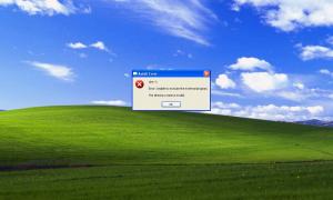

I have 2 questions about the Nero 8.1.1.0b autoit script.
First:
For the variable $ID, what is wrong with my installation directory code? The script generated an error during install saying my installation directory was not valid.
Below is the code I used in the .au3 file:
$ID = @ProgramFilesDir & "\Nero"
Second:
I don't understand what I need to put for the $EF variable. I have just been leaving it blank, as I am simply running the .exe package I directly downloaded from Nero. Is that what I should be doing?
$EF = ""; Already extracted folder example: $EF = "D:\Apps\Extracted\Nero8"
Any help to these questions would be greatly appreciated! Thanks a lot for the amazing script, btw!
Edited by radigast
You don't have to specify any path when using this script. Leave these settings blank as it will use the standard directory for your programs anyway. These settings are for more experienced users who want to install in/from a different location and they have to be fixed as it seems it will not work when adding macros like @ProgramFilesDir.
