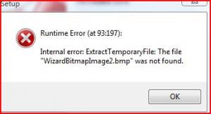

When installing I got a mistake (see capture). It is very small mistake in the script, easi;y fixed from info in picture. Mistyping of some kind, that's all.
Code error is more serious looking, happens while building, but I just took code from europe version and replaced it to eng version lite. It's on the line with word rollback as I recall. Mistyping again I quess but I decided to check script with code from europe version and it worked so Iquess mistake is in the code, not script., but as ir does not have nothing with functionality of Nero itself I decided not to dig, just to replace.

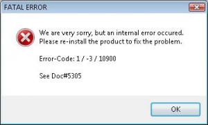

I have exactly the same error window as you. I install nero lite with /VERYLSILENT switch on a unattended vista dvd. Then, I import this reg file :
; User information
[HKEY_LOCAL_MACHINE\SOFTWARE\ahead\Installation\Families\Nero 7\Info]
"User"="Kal"
"Company"="Kal"
"Serial"="xxxx-xxxx-xxxx-xxxx-xxxx-xxxx-xxxx"
"MissingFilesState"="0"
"EulaAccepted"="1"
If I launch nero I get the FATAL ERROR window. If I remove the serial from the registry, then I can enter it manually with Nero ProductSetup. After that, It works like a charm. It just add the serial in the same registry location, except the key name is something like "Serial7_XXXXXXXX", but I can rename it to "Serial" without any problem. So, what's going on ? :(

Don't import your serial after setup! Activation is only done through Setup! This is no rocket science! :realmad:
Edited by Acheron
Activation is still a bit problematic, so I programmed the activation progress to only register once. It is best to use the /SERIAL="xxxx-xxxx-xxxx-xxxx-xxxx-xxxx-xxxx" switch when using unattended. Manually importing regfiles won't work on a clean system!

Ok, I've tested /SERIAL switch and it seems there's a little issue to fix.
Indeed, when I install it for the first time, there's no serial entry added to registry. But If I install it a second time, then a serial entry is correctly added. I do the installation during the first boot, in the "specialize" pass.
Is there a way to use SetupX.exe silently to do the registration ?
