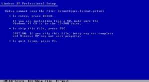

hi! i'd just like to report what happened in my recent tests last weekend using 61129a with a Dell OEM XP Pro SP1a & regular XP Pro (still not my pc ) ... (1) got lots of word.format.ps1xml (i.e., certificate.format.ps1xml, dotnettypes.format.ps1xml, filesystem.format.ps1xml, help.format.ps1xml, powershellcore.format.ps1xml, powershelltrace.format.ps1xml, registry.format.ps1xml) & sstext3d.scr, types.ps1xml ... i opted to go for: To skip this file, press Esc. just to see what happens after installation ... was able to get rid of these by removing WindowsXP-KB926139-x86-ENU.exe (2) i likewise encountered " ... framedyn.dll was not found., immediately followed by "Error loading srclient.dll" errors; (3) some addons are not present after install ... even wmp11 (either addon or the .exe) was not present attached are some files & pic that may help clarify the issue ... also, it might be too much too ask but TC & the_guy, would it be possible to request for your hotfixes list (as these are very good references ) to include as notes as to which hotfix(es) has(have) superceded other hotfix(es)? (4) HFSLIP run-times were longer than usual (perhaps because i was using a slower pc & running it from an external USB drive ) even if i had taken out lots of switchless installers from HFSVCPACK_SW dir thanks!
