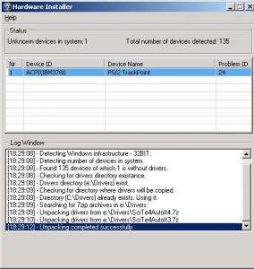

  13. Just to keep you guys posted.. i decided to add some screenshot. Not best quality but will give you *HINT* on new features that will be implemented in newest version. New features: - Full support for 7zip/Rar packed drivers - Optional backup of c:\Windows\Inf directory before applying drivers - New look - Ability to configure .ini file thru GUI (not realy sure i need it but i'll try to implement it if i get time ;p) - Possibility to copy drivers to for example C:\Drivers for later use (a must to set when using packed_drivers) - Optional output to log_file (usefull for debugging) - Optional output_option = Full/Simple - with Full mode on 99% of what's happening including output from external programs will be placed in log. (usefull for debugging but might slow down program a lot) - Information if Windows require reboot to use drivers or not - Automatic or Manual start (by pressing button). - Auto autorun file creator for easy deployment on CD. Suggestions are welcome as i haven't done everything yet so i can change things. Later on it will be much harder (althought with log window instead of preset GUI it's much easier to change things. Hope you guys will like the changes in new version. Hopefully out sometime soon.
