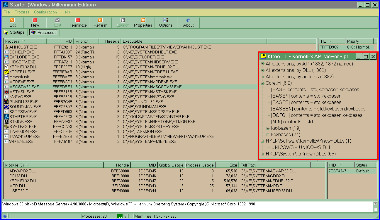

  17. I have just got one of my recent builds working with KEX25. What I discovered was that the original SessionManager KnownDLLs from a fresh OS install need to be there with KEX25. I took them from the working KEX25. If you look at my KEX25 picture it will show 65 of them which were only System files which pointed to themselves. What I did was to take my working new build SessionManager 32bit KnownDLLs and export them. I then booted up an advanced build in safe mode placed in the KEX25 modules except Core.ini and used the Core.ini in my last post then merged the new install SessionManager KnownDlls. Then I merged the AppSettings.zip I uploaded. This got an advanced build working and no scripting error occurred and should not happen just on a merge. The *\MSVC* then can be changed to suit a 2K like mode in the AppSettings and this includes DCFG1 in later KEX as I mentioned some while back and duplicates removed. If after removing duplicates and upon reboot problem returns, the merge procedure needs repeating again in Safe Mode and register KexCom again in Safe Mode. That is what I did as I removed *\MFC*U instead of removing *\MFC* but I did not do this intentional mistake second time. DCFG1 does not work if the application stipulates that a 2K or higher operating system is required though. Thank you for making changes to Kstub Jumper. To make things easier I will upload new requirements soon.

  20. As can be seen in the Ktree11 picture, Unicows is a KnownDLL. If Unicows is used this way there will also be a need of a copy of it in the System folder if the KernelEx folder is not a mapped environmental directory. This is because if a program is KEX disabled or calls Unicows as an implicit then it will find Unicows in the System folder. Same goes with any other modules as a KernelEx KnownDlls. I have had both Unicows actively loaded in both directories at the same time. It is not necessary to have Unicows as a KernelEx KnownDll and I will probably remove it soon. The method of getting KEX25 to work works from a complete 4.5.2 install so the other KernelEx KnownDlls have been installed and the install method worked. The SFC control panel looks like picture on a new build but looked different on old build and was disabled.

  23. Even though Msgsrv32 is 16bit, KEX can be in use as seen in KEX24 picture. The top image is of the newer install with KEX25 prior to Volumouse and the bottom one is from a different build with KEX24. I have looked on a build with KEX12 and KEX is in use on Msgsrv32 also. It is because Volumouse (Vlmshlp) is hooking Msgsrv32 and dragging along KernelEx. Mmtask.tsk on KEX24 build is from an early Whistler release and is 32bit. EDIT mistake. These 2 builds of mine have System Monitor CPU usage of a certain percentage as can be seen. I think is accurate now and is something to do with 16bit and the registry. Some people have dismissed this as a false reading but I have had it zero on one build and that build had server buffers at zero at the time. It is to be noted that the registry is running top down in Win9x and bottom up in WinXP I think, from my memory of such. This is likened to Ntdll linking directly to Kernel32 and is loaded in Win9x where as NT OS versions Kernel32 loads calling Ntdll.
