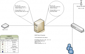

	Huh you sure have SOME configuration there lol ... having multihomes server as DC (server with more than 1 NIC) is not supported by MS. Anyway, you would have to install a DHCP server bebore you go further, and once installed, authorize it in Active Directory, next, disable DHCP on the DLINK modem/router, same with wireless router. I will make you small drawing how this should be done ...
