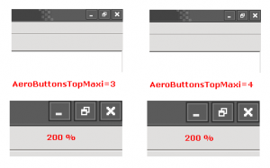

  14. They are really better, but FWIW, I would have use a value of 4: HTH

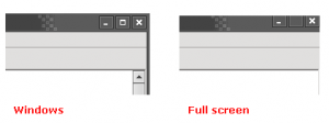

  16. Thanks for your work! - BLACK_RESTOREGLYPH_BMP.bmp is missing - IMHO there could be a glitch (I'm not sure) when one maximize a window: the edges are no more seen and the top right buttons are cropped. EDIT: BLUE_RESTOREGLYPH_BMP.bmp and LUNA_RESTOREGLYPH_BMP.bmp are the same. So, maybe we only need to make a third bitmap called BLACK_RESTOREGLYPH_BMP.bmp or to modify the skin_Black.ini that it will use one of these two.
