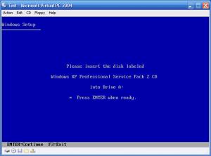

  7. I have created from scratch a complete multiboot cd of XP Home and Pro OEM I used Integrator to add ryan addon 1.1 Media player 2 and hotfix pack2 then powerpacked into an iso but when i try to use it i get and error when booting the pro version.... home works great... This is the screen i get, Any ideas Siginet...?
