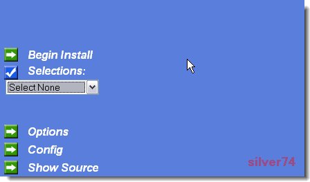

silver74 Posted September 29, 2006 Share Posted September 29, 2006 I think i have find a bug I want to try to use the transitions option,but if you use this on your wpi the liste of programmes in your database will not show.Its not realy a big bug,but some people can be affraid to think to loose all here work.Look:Before my window seems like thisif you takes the options transitions to onAfter my window seems like thisCan you tell me what is the probleme? Link to comment Share on other sites More sharing options...
