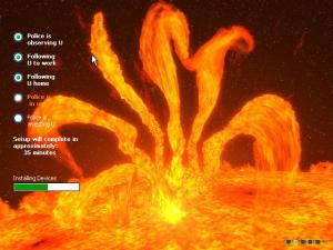

Here is my first, idea from Laus_Sane first cristina.
I thought I was having troubles converting the image, must have tried it about 50 times, and kept getting this.
Then after a while it occured to me it could just be vmware as image was fine running setup in windows. so then tried virtual pc...
Which looks a lot better :)
Except for now I realise it is not showing time left? All I think I did was change the "Setup will complete..." to "Unattended Installation will complete..." any ideas?
Still got to change the squares down the bottom right, but haven't decided on what to do there. Also check to see if the square under the writing will line up when installing normaly on a computer (besides using small bootup VPC). At 1600x1200 writing is way off, 1024x768 seems to just fit in so i think it should be ok though.
