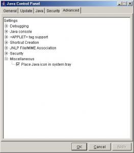

Open Java control panel, click on Advanced tab, expand the "Miscellaneous" section and check the "Place Java icon in system tray" option (if this option is unchecked, enable it). Click OK, close your web browser and restart it. Now go to the GENS web site and the Java icon should appear.
Edited by erpdude8
Here's what I mean by the picture of Sun Java icon system tray option in Java Control panel applet-

Okay, went to the Java Control Panel, clicked on Miscellaneous the checked "Place Java icon is system tray"...then went to http://gens.consolemul.com/, STILL NO ICON NEXT TO THE TIME OR IN THE SYSTEM TRAY, SAME THING..
Java IS installed on my machine, the latest version. 1.5.07, but also have MSJVM still installed. You got the ICON and a I didn't. That means my computer thinks Sun Java is NOT installed or can't find it or both.
