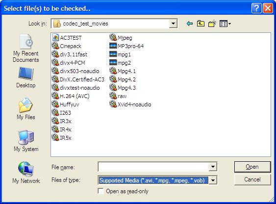

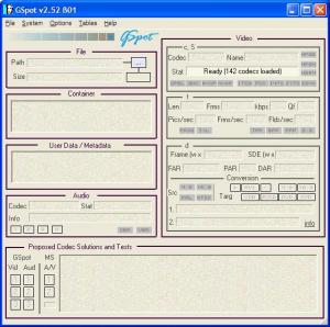

tain Posted July 18, 2006 Author Posted July 18, 2006 So QT works pretty well for you, huh? Except no browser plug-in, right?Gspot link, and report info:Please list this info for the affected video: 4CC, compatible video codecs, and stream type. This is all reported by gspot for a properly encoded file. AFTER you get this data, click on RENDER, wait for it to finish, and then click on "Rendering successful (click for details)". I'd be interested to hear what is in there as well.33 files is correct. Don't forget to add in the QT pack since it works for you but is separate now.
Kiki Burgh Posted July 24, 2006 Posted July 24, 2006 (edited) hi Tain!i'm sorry for not being able to get back to you the soonest on this ... here are some findings that are kinda embarrassing since i thought the files were playing for me ... this time i used your test files ... i'm not sure though if these are what i need to post (or if i did the right thing in running the gspot tests) ...Applemov/Audio-AAC quicktimeRendering failed: Following is erro reported by DirectShow:0x80040265: Cannot play back the file. The format is not supported.divx4-PCM(Src)-->(A)-->[AVI Splitter ]>---->[DivX Decoder Filter ]>--[C]-->[Video Renderer ]Video Render OK. Use [3] to play.Failed to connect Output pin 0x00acaaec ["stream 00"] on AVI Splitter to input pin 0x00aca...divx503-no audio*basically the same w/ above ...Failed to connect Output pin 0x00b1f9a4 ["Stream 00"] on AVI Splitter to input pin 0x00afeaDivX.Certified-AC3*basically the same w/ above but different Output/Input pinsMP3pro-64*basically the same w/ above but different Output/Input pinsH.264-2Render: Partial FailureH.264 (AVC)/Huffyuv/I263/Unable to render the videoIR4xVideo Render OK. Use [3] to play.(Src)-->(A)-->[AVI Splitter ]>---->[VFW: Intel Video Video 4.5 ]>--[C]-->[Video Renderer ]Video Render OK. Use [3] to play.(SRC)-->(A)-->[AVI Splitter ]>---->[Nero Quicl Time Video Decoder ]>-->[Nero D...]Failed to create instance of Nero Digital AVC Video Enc. CoCreateInstance() failed. Error: ...Mpg4.1/Mpg4.2/Mpg4.3*basically the same w/ above but different Output/Input pins PLUSFailed to create instance of DMO filter Mpeg4 Decoder DMO. Error: 0x80004002: No such instance ...attached here too is an error screenshot when i used VLC; i added too some text files (which i'm not certain if it would be of any use to the issue) thank you!EDIT: btw, i haven't tried running the tests though w/ the newly uploaded QT files Audio_Known_Compression_Formats.txtVideo_Known_Compression_Formats.txt Edited July 24, 2006 by Kiki Burgh

Kiki Burgh Posted July 25, 2006 Posted July 25, 2006 hi Tain! here are some more datai gathered using VM this time ... used the latest codec pack (w/ 33 files in it) in HFEXPERT\CODECS + wmfdist95.exe in HFUnder Proposed Solutions and TestsGSpotVid AudAC3TEST / H.264 (AVC) / Hyffyuv / I263 / mpg2 / raw /Unable to render the video***please note that for the formats above under Stat shows: Codec are NOT Installed divX4-PCM[src]-->>--[A]-->[AVI Splitter ]>---->[DivX Decoder Filter ]>--[C]-->[Video Renderer ]Video Render OK. Use [3] to play.[scr]-->>--[A]-->[AVI Splitter ]>---->[XviD MPEG-4 Video Decoder ]>--[C]-->[Video Renderer ]Failed to connect Output pin 0x00a5f83c ["Stream 00"] on AVI Splitter to input pin 0x00a729fc ["XForm In"] on filter 0x02065094 [XviD MPEG-4 Video Decoder']. ConnectDirect[] failed. Error: 0x80040207: There is no common media type between these pins.divx503-noaudio***similar with results above (except for the Output/Input pins)MP3pro-64[src]-->>--[Elecard MPEG2 Demultiplexer ]>---->[ACM:MPEG Layer-3 Audio Codec for MSACM ]>-->[Default DirectSound Device ]Failed to connect Output pin 0x00aaxb44 ["Src Media"] on MP3pro-64.mpeg to input pin 0x03021ca4 ["Input"] on filter 0x02054b84 ["Elecard MPEG2 Demultiplexer"].ConnectDirect[] failed: Error: 0x80040207: There is no common media type between these pins.[src]-->>--[A]-->[Elecard MPEG2 Demultiplexer ]>---->[MPEG Layer-3 Decoder ]>--[C]-->[Default DirectSound Device ]Failed to connect Output pin 0x043b0c1c ["Src Media"] on MP3pro-64.mpeg to input pin 0x03010a4c ["Input"] on filter 0x02054b84 ["Elecard MPEG2 Demultiplexer"].ConnectDirect[] failed: Error: 0x80040207: There is no common media type between these pins.[src]-->>--[A]-->[MPEG-I Stream Splitter ]>----[ACM:MPEG Layer-3 Audio Codec for MSACM ]>--[C]-->[Default DirectSound Device ]Audio Render OK. Use [3] to play.[src]-->>--[A]-->[MPEG-I Stream Splitter ]>----[MPEG Layer-3 Decoder ]>--[C]-->[Default DirectSound Device ]Audio Render OK. Use [3] to play.mpg1Aud[src]-->>--[A]-->[Elecard MPEG2 Demultiplexer ]>---->[ACM: MPEG Layer-3 Audio Codec for MSACM ]>--[C]-->[Default DirectSound Device ]Failed to connect Output pin 0x0300b8bc ["Audio 0 0Xc0"] on Elecard MPEG2 Demultiplexer to inputpin 0x0441665c ["Input"] on filter 0x020487b8 ["MPEG Layer-3 Audio Codec for MSACM"].ConnectDirect[] failed. Error: 0x80040200: An invalid media type was specified.[src]-->>--[A]-->[Elecard MPEG2 Demultiplexer ]>-->[MPEG Layer-3 Decoder ]>--[C]-->[Default DirectSound Device ]Failed to connect Output pin 0x03006e9c ["Audio 0 0xC0"] on Elecard MPEG2 Demultiplexer to input pin 0x043e815c ["XForm In"] on filter 0x02052ae2 ["MPEG Layer-3 Decoder"]. ConnectDirect[] failed. Error: 0x80040207: There is no common media type between these pins.***basically the same for the succeeding 4 lines except for the Output/Input pins & [MPEG-I Stream Splitter ]>---->[ACM:MPEG Layer-3 Audio Codec for MSACM] & -->[MPEG Layer-3 Decoder ]attached are some screenshots:just to show in text format (the supported & unsupported files, here's what i got:Supported Media (*.avi, *.mpg, *.mpeg, *.vob)C:\codec_test_movies\divxtest-noaudio.aviC:\codec_test_movies\H.264 (AVC).aviC:\codec_test_movies\Huffyuv.aviC:\codec_test_movies\I263.aviC:\codec_test_movies\IR3x.aviC:\codec_test_movies\IR4x.aviC:\codec_test_movies\IR5x.aviC:\codec_test_movies\Mjpeg.aviC:\codec_test_movies\MP3pro-64.mpegC:\codec_test_movies\mpg1.mpgC:\codec_test_movies\mpg2.mpgC:\codec_test_movies\Mpg4.1.aviC:\codec_test_movies\Mpg4.2.aviC:\codec_test_movies\Mpg4.3.aviC:\codec_test_movies\raw.aviC:\codec_test_movies\Xvid4-noaudio.aviC:\codec_test_movies\AC3TEST.VOBC:\codec_test_movies\Cinepack.aviC:\codec_test_movies\div3.11fast.aviC:\codec_test_movies\divx4-PCM.aviC:\codec_test_movies\divx503-noaudio.aviC:\codec_test_movies\DivX.Certified-AC3.aviAll Files (*.*)C:\codec_test_movies\mazegame2.swfC:\codec_test_movies\Mjpeg.aviC:\codec_test_movies\MP3pro-64.mpegC:\codec_test_movies\mpg1.mpgC:\codec_test_movies\mpg2.mpgC:\codec_test_movies\Mpg4.1.aviC:\codec_test_movies\Mpg4.2.aviC:\codec_test_movies\Mpg4.3.aviC:\codec_test_movies\raw.aviC:\codec_test_movies\Rm.rmmC:\codec_test_movies\Wmv7.wmvC:\codec_test_movies\Wmv8.wmvC:\codec_test_movies\Wmv9.wmvC:\codec_test_movies\WMV9-.wmvC:\codec_test_movies\Xvid4-noaudio.aviC:\codec_test_movies\AC3TEST.VOBC:\codec_test_movies\Applemov.movC:\codec_test_movies\Applemp4.mp4C:\codec_test_movies\Asf.asfC:\codec_test_movies\Audio-AAC quicktime.mp4C:\codec_test_movies\Audio-Ogg VBR.oggC:\codec_test_movies\Audio-RM8_64.rmmC:\codec_test_movies\Audio-WMA8-64.wmaC:\codec_test_movies\Cinepack.aviC:\codec_test_movies\div3.11fast.aviC:\codec_test_movies\divx4-PCM.aviC:\codec_test_movies\divx503-noaudio.aviC:\codec_test_movies\DivX.Certified-AC3.aviC:\codec_test_movies\divxtest-noaudio.aviC:\codec_test_movies\H.264-2.movC:\codec_test_movies\H.264 (AVC).aviC:\codec_test_movies\Huffyuv.aviC:\codec_test_movies\I263.aviC:\codec_test_movies\IR3x.aviC:\codec_test_movies\IR4x.aviC:\codec_test_movies\IR5x.avithanks!
