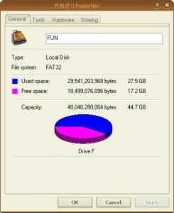

You can format a FAT32 partition larger than 32GB with Windows 2000/XP, but you can not create a partition larger than 32GB with Windows 2000/XP. Also note that you can not format FAT32 partitions larger than 32GB during install.
You cannot format a volume larger than 32 GB in size using the FAT32 file system in Windows 2000. The Windows 2000 FastFAT driver can mount and support volumes larger than 32 GB that use the FAT32 file system (subject to the other limits), but you cannot create one using the Format tool. This behavior is by design. If you need to create a volume larger than 32 GB, use the NTFS file system instead.
You cannot format a volume larger than 32 gigabytes (GB) in size using the FAT32 file system during the Windows XP installation process. Windows XP can mount and support FAT32 volumes larger than 32 GB (subject to the other limits), but you cannot create a FAT32 volume larger than 32 GB by using the Format tool during Setup. If you need to format a volume that is larger than 32 GB, use the NTFS file system to format it. Another option is to start from a Microsoft Windows 98 or Microsoft Windows Millennium Edition (Me) Startup disk and use the Format tool included on the disk.
