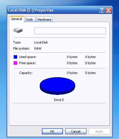

i have a 120gb divided into 3 partitions. i've accidentally damaged my 2nd partition. the 1rst and 3rd partition was successfully recovered by scandisk. please help? what free prog can i use to recover it? explorer recognizes the drive but it says that it is corrupted/unreadable and on the property it says raw. can i delete the partition and recover it again? thanks.

Here you need a data recovery tool.
The best FREEWARE one is TESTDISK:
http://www.cgsecurity.org/index.html?testdisk.html
Make sure you READ the docs before using it.
Even if Testdisk fails in recovering the partition, the (included in the download) PHOTOREC might be able to recover most of the files in the partition.

Once and for all, Partition Magic is NOT capable of RECOVERY of a damaged partition or of the data within it:
http://www.powerquest.com/partitionmagic/features.html
It is a tool to create/tune/resize/modify/change/split/merge partitions, it also includes a boot manager.
By using the recovery floppies it is possible IN A VERY SMALL NUMBER of cases, to undelete a partition, that's all.
It is the direct match with Acronis Partition Manager and Acronis Boot Manager, NOT with Acronis Recovery Expert, which is a good app to recover data/partitions.
Windows Disk Administration CANNOT recover partitions, using it may result in losing any chance of recovery.
As said in the linked posts and elsewhere on the board, there are just two FREEWARE data/partition recovery tools:
TESTDISK (and PHOTOREC)
http://www.cgsecurity.org/testdisk.html
