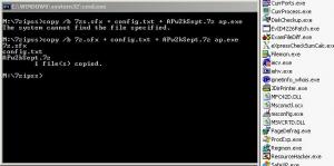

OK, this is probably a stupid question, but is there any way to get your config.txt file back if you deleted it after doing the copy command? I've tried running the installer and looking in the temp directory and only the files from the .7z archive are there, and extracting the installer gives me the same thing.
AFAIK, you can't. The files other than the .7z files (7zS.sfx, config.txt) are included in the executable, and not part of the archive that is extracted. That's why when you extract the archive, you only get the contents of the 7-zip file.
You could try this in Command Prompt.
Find /I "RunProgram=" "path\to\file.exe"
