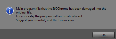

I can't start the browser, it says I need to check it for Trojan viruses (suggests Trojan scan).
All in broken English. Not recommended to run for your "safe".

No, I didn't.  I had it when I tried to mod the 64-bit version, which is not surprising.
I wrote here yesterday, link>, I can run 2036 perfectly fine (with or without my starter). I just don't, it's too bright for me.
On the testing Vista PC - no AV.
The skin is yours, I ran it as it was supplied (before making the decission whether I like it or not).
The grey colour in the error because I use the dark Vista theme from pinterest (it's very common here, on this website).

I run it with all bloat removed, incuding d3d47 and LibGL. Of course no "doctor". Didn't you read the Trojan message? It says "damaged", not "missing".

If you read, it even tells which file is damaged, namely it's 360chrome.

It is the "crash reporting" that is edited out of the .exe and also the Chinese text.
I wonder if it is the removal of the "crash reporting" or the removal of the Chinese file description, product name, or product short name?  --  I could provide different versions of the .exe if you are truly interested in testing.
I do not get the errors and you are the only one that does - doesn't make it invalid, of course, and we can fix it.
