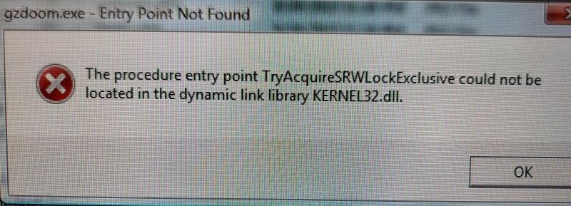

OldSchool38 Posted October 6, 2023 Author Posted October 6, 2023 Have a new issue today trying to run the current version of GZDoom, anyone know what this is?
Dixel Posted October 6, 2023 Posted October 6, 2023 Open up gzdoom.exe with CFF Explorer and replace with the same string, but without "Try". Make a backup before! 1
OldSchool38 Posted October 7, 2023 Author Posted October 7, 2023 Looked up and got my hands on CFF Explorer, but have no clue where to find the string you mentioned-looks like a pretty powerful tool though once I figure it out!
UCyborg Posted October 7, 2023 Posted October 7, 2023 (edited) Getting forgetful, aren't we? Well, I am too or I never knew for sure, but it was common for software to stop working on XP and Vista simultaneously with newer versions. Edit: Maybe not in this case. https://forum.zdoom.org/viewtopic.php?t=57394 Maybe 4.10 still works, at least gzdoom.exe doesn't have TryAcquireSRWLockExclusive in the import table. Edited October 7, 2023 by UCyborg
Dixel Posted October 7, 2023 Posted October 7, 2023 15 hours ago, OldSchool38 said: Looked up and got my hands on CFF Explorer, but have no clue where to find the string you mentioned-looks like a pretty powerful tool though once I figure it out! Go to "import directory/kernel32" and search there. 2
OldSchool38 Posted October 8, 2023 Author Posted October 8, 2023 16 hours ago, Dixel said: Go to "import directory/kernel32" and search there. Excellent! GZdoom is fixed now! Tried it out with doom2, ultimate doom, heretic-works great! GZDoom 11 will work with Vista!
