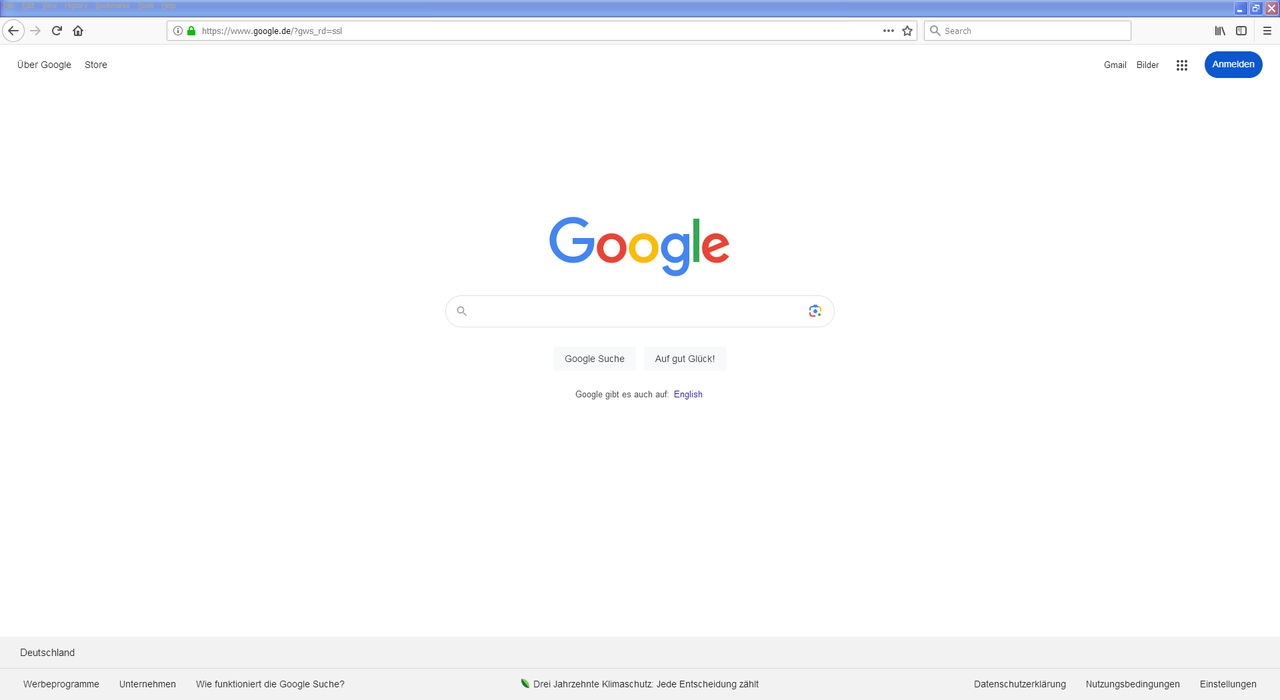

On 8/21/2024 at 12:07 AM, AstroSkipper said:
@tinman2000 Is that what you had in mind? :dubbio: Mypal 68.14.3b without tab bar and new tab button:
:P

Make the tab bar invisible in Mypal 68
@tinman2000 This is the code of my self-created tabs-toolbar-invisible.css file to make the tab bar invisible in Mypal 68. This file has to be created in the mypal_profile_folder\chrome\css folder (mypal_profile_folder has to be replaced by the name of your profile folder, of course):
#tabbrowser-tabs {
  visibility: collapse !important;
.tabs-newtab-button {
  display: none !important;
As you can see, it is a short code which was created and successfully tested by me in a new, clean profile. Contrary to the code you linked to, I modified only relevant IDs and classes. And just for clarification, CSS code can't really remove elements but change their appearance, i.e. in this case make them invisible. Whether this CSS stylesheet also works in a heavily customised profile, I can't say. This has to be tested by the user. If necessary, the code must be modified then. And this is how your userChrome.css file in the mypal_profile_folder\chrome folder should look like:
/* Copyright (c) 2017 Haggai Nuchi
Available for use under the MIT License:
https://opensource.org/licenses/MIT
@import "./css/tabs-toolbar-invisible.css";
@namespace url(http://www.mozilla.org/keymaster/gatekeeper/there.is.only.xul);
toolbarbutton#alltabs-button {
    -moz-binding: url("userChrome.xml#js");
You see the tabs-toolbar-invisible.css file has to be imported by the userChrome.css file. The advantages of this approach is the modularity of your CSS implementations and the better overview. You always know exactly which code was responsible for what and can quickly activate or deactivate certain CSS stylesheets. The deactivation of the file tabs-toolbar-invisible.css is done inside the userChrome.css file as follows:
/* @import "./css/tabs-toolbar-invisible.css"; */
The requirements for use is, as already mentioned, the package MYPAL_68_CB_requirements.7z provided by me in the first post of this thread. If all done, your browser with a new, clean profile should look like this:
